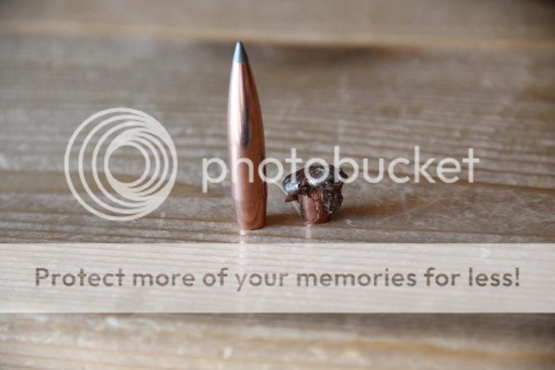

Real world - as in not into a piece of pine - results...
http://www.canadiangunnutz.com/forum/showthread.php/987591-**White-Tail-added**-Field-report-on-7mm-RM-168gr-LRAB-Mule-Deer
83.6gr out of the initial 168gr left....
