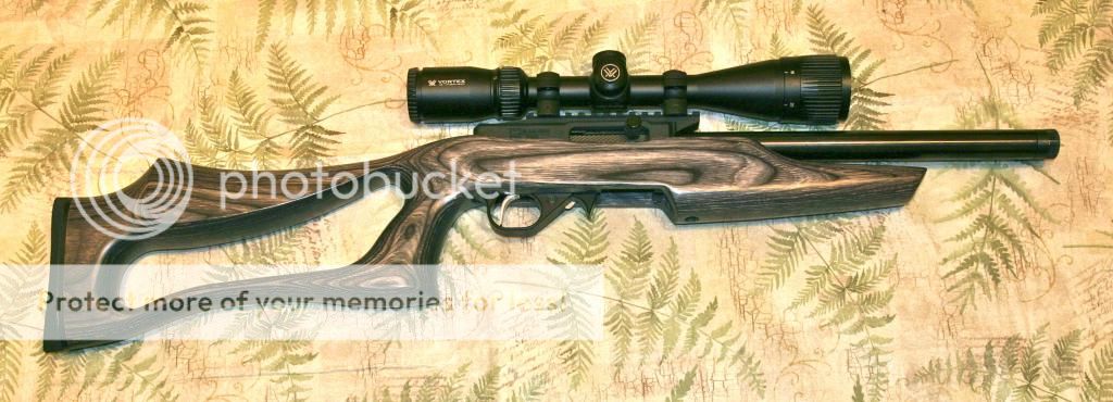

I was looking at 12.5" dlask 10/22 barrel and was wondering what type of accuracy people were getting out of them? I have a 13" norinco backpacker that is maybe minute of gopher at 50yards with decent glass but that isn't saying much, I also seen a 16.5" barrel but don't remeber the brand, but considering that one as well, any input is appreciated, post a pic of yours too if you like! Everyone likes pictures, here's one of the backpacker,

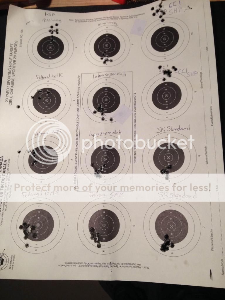

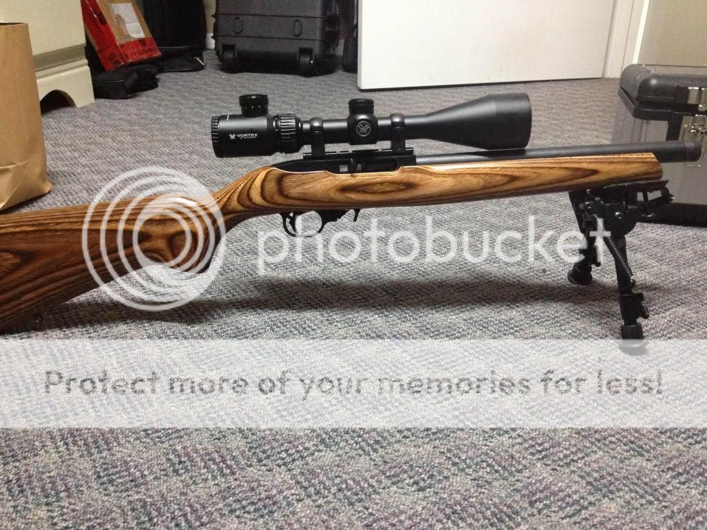

you wont be disappointed with the dlask 12.5" barrel. Mine is very accurate for a 10/22. See the pic below of my ammo test I did at 50 yards. All groups are 10 shots and shot prone off a bi-pod and rear bag. I tested CCI mini mags, CCI segmented hollow points (CCI SHP), SK Standard, Federal Gold Metal Match (Federal GMM), Federal 525 bulk blue box and Lapua Super Club. Looks like SK Standard is the one my gun shoots the best. Scope is a Vortex 3-9x50.
The type of chamber on the Dlask 12.5" barrel with have a big impact on accuracy. Mine has what Dlask calls the "X-treme" chamber, this is a Bentz chamber and is very accurate (i.e.: 3/8" at 50 yards with Federal Auto Match if I do my part). I have read that Dlask no longer offers this chamber. You now have the choice of the "Target" or "Sporter" chambers. The X-treme/Bentz chamber is very tight, this restricts the type of ammo it can use and can lead to extraction problems and long/painfull break in periods. I love mine now, but it took quite a bit of tuning, breaking-in and adjustment to make it run well.
