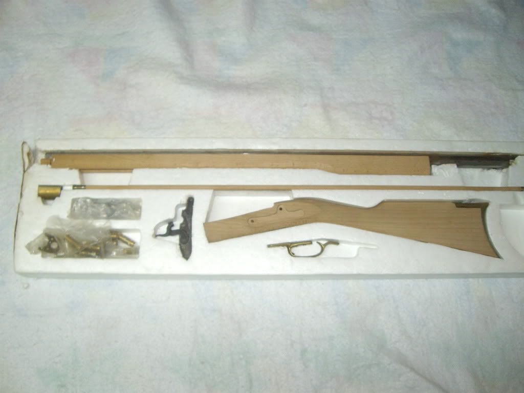

Your rifle may have started out as a kit with a percussion or flint lock,here are some pictures of the kit before building, mine has a Jukar barrel made in Spain:
[URL=http://s989.photobucket.com/user/Skinny1950/media/KentuckyRifleopenbox.jpg.html]
[/URL]
1 do not clean between shots we did try that and no real change in the problem.
2 we use bore butter, as a lube on patches mostly . and YES our rifle is same as your photo but it is percusion -cap. we bought it as found no idea if it was a kit gun or not .
