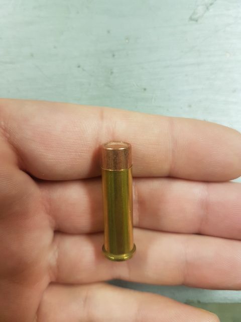

I know that you are correct insofar as lead bullets are concerned. The issue is that these plated bullets (CamPro)do not behave like cast lead bullets do. What B. is suggesting would probably not work with cast lead bullets, but I do have a hunch, based upon prior experience, that he is correct. When I first bought these bullets, I did indeed seat the first batch with the bullets protruding from the case about 1/8 of an inch, and they actually grouped better than flush bullets.

I seat the bullets out about 1/8 inch, very little crimp, in a .38 special case.

With bullets seated at about 1.4 COAL, in .357 cases, 4.5 grains shot better than all loads that I have tried thus far in .38 Sp. cases.
