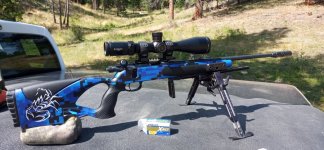

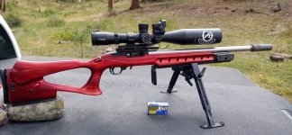

In my opinion when using a tripod, the legs should be 90 degrees to the bore! If they are angled either forward or backward as shown in many photos on here, the groups will suffer. Before some of you blow a gasket, which I know is gonna happen. Im not saying great groups cant be shot off a bipod with the legs tipped but better groups are available with the same gun with the legs 90 to the bore.
I shoot off of front and rear bags. Trial and error has taught me that using a bipod on a hard concrete or wooden surface such as a shooting bench may result in upwards "muzzle jump" just as the round is fired. Through experimentation I have determined that the use of a bag results in straight-back recoil rather than the upwards jump that I experienced using a bipod. It didn't seem to matter how I loaded the bipod - I still got muzzle jump immediately upon firing. So I now reserve bipod use for the field, period.

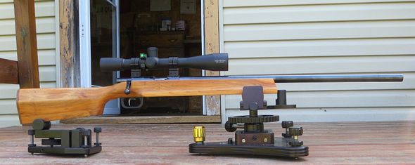

When a one-piece rest such as the one shown by Shorty is not available, a mechanical rear rest such as that made by PQP combined with a good quality front rest may be the next best choice for rimfire benchrest shooting.

I prefer my caldweld deluxe front rest because. Has better adjustability and not all my guns can run my Mpod.
