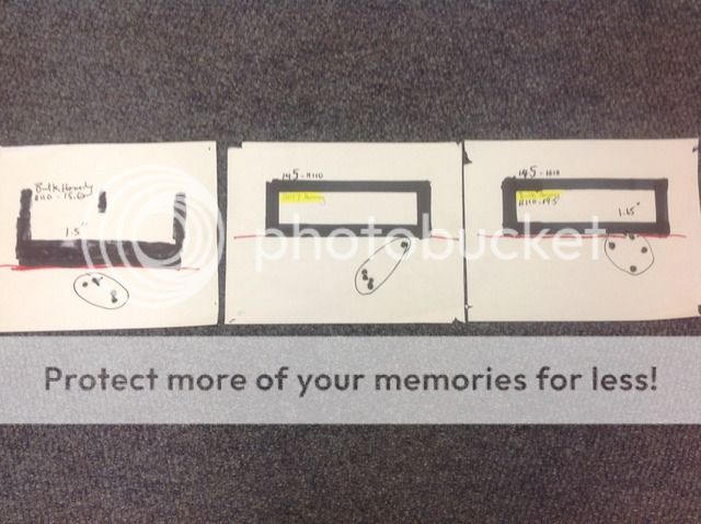

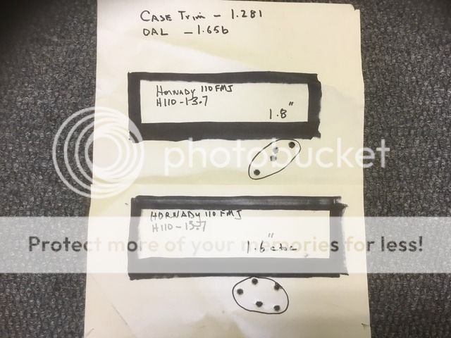

Thanks for the heads up regarding charge weights. I am loading in small batches (15 at a time) just in case I see pressure and need to trash a few. I will be using only 110gr FMJ for the time being, pushed by H110, and lit with CCI BR4's. My start load was 13.7gr (15.0gr is the listed max) and will next try 14.5gr...and if everything looks OK, on to the full 15gr. I am starting to think of a rear mount for a red dot as these old eyes don't focus quite like they should. The rifle is a new Auto Ord so should be solid.

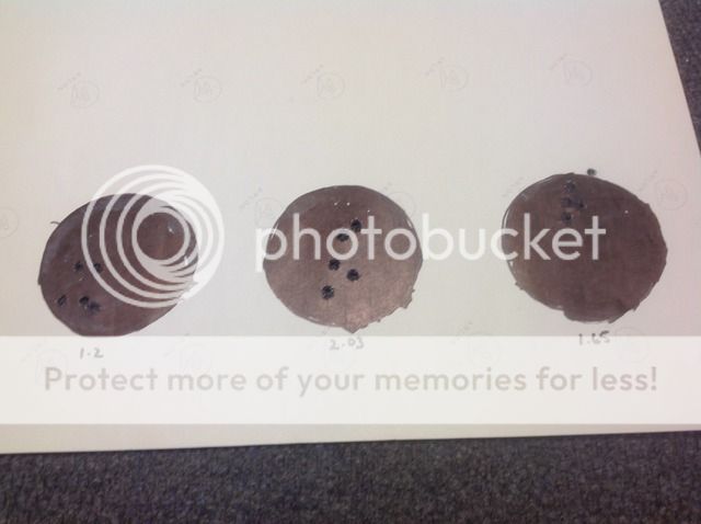

Braved the wet and windy weather and found it not too bad for shooting. Target on the right is bulk Hornady with 14.7 gr H110 // Middle is Hornady "boxed" bullets with 14.7 gr // Left target is bulk Hornady with 15gr H110 which is Hodgdons Max. Looks like the bit of velocity increase has changed barrel harmonics enough to bring the windage POI to the same as POA, (POA is with the top of the front sight just a tickle below the red line).
Is it time to file a bit more off the front sight or should it wait a bit?

Magnetospeed says 15.0 gr of H110 is pushing these 110gr Hornady FMJ's about 2020 fps. This NR Auto Ordnance has an 18.6" barrel.
Not familiar (yet) the peep/blade combination, but it looks to me that some file work on the front sight to slim it down could be advantageous?
I am finding the peep/blade combination a bit of a challenge.. Most 100M groups are 4-5". Once winter rolls in, I am going to tinker with some bedding ideas, file the front sight a bit narrower, and reduce trigger creep.
I am also staring to think that group consistency may suffer as a result of the rather generous headspace which might be resolved pretty easily by setting trim brass trim length to 1.286? Any thoughts in this regard?
I trim mine to 1.285". I have a good selection of bolts, and was able to headspace all of my carbines to the 1.290" mininum. This gives me .005" headspace on all of them which is reasonable and ensures that there will be NO out of battery issues to worry about. My pet handload is 14.9grs of H110 or Win 296. Both of these powders have produced phenomenal groups @ 100m with Hornady and Sierra 110gr FMJ's. Generally, the 110gr soft points are a bit more accurate, but that is subjective...

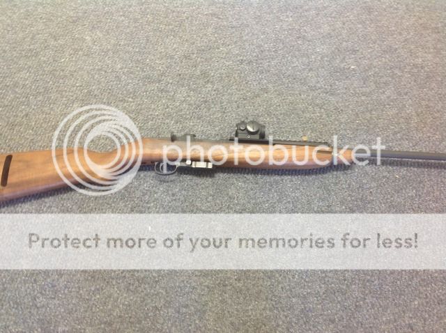

Installed an Ultimak rail so I could put on a red dot which should give me a better idea of the the rifle's potential as I am still not comfortable with the peeps. Too windy to shoot at 100M today, so backed off to 50M to see what would happen. Right and center group shot with the same dot intensity, one on the left a bit brighter. I have a type 1 Barrel band and have shimmed it with a piece of aluminum pop can to reduce movement, but it looks I am getting a some change in POI. (Could be the mount turning on the barrel?) Suggestions/ comments?
If the groups are all with the same ammo, then the POI change could be the mount coming loose, or the barrel heating up, or...
Too many variables to diagnose over the internet. One other thing to check is that when the action is in the stock, that the barrel is centered in the stock channel, and that the sides of the slide don't rub on the inside walls of the stock when slide is all the way forward. To check this you assemble the gun without the handguard so you can visually inspect.
