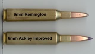

Ackley Improved
That's true OB, but it has come to mean any case improved with a 40 degree shoulder that you can still use regular ammo in. There are AI's in calibers that weren't invented when PO left the stage, the 260 AI for example. A properly chambered and handloaded 270 AI will not "smoke at both ends" unless something is wrong somewhere. - dan
AI's are OK but there's no magic in them..I've done them in 223AI, 7-08AI and 280AI..all pushed the bullet clear thru the bore just like the parent cases did...albeit, a bit faster;)....the case stretching thing may have merit for some, I just wish I could shoot any cartridge enough to where case stretching became a problem.....I'd love to shoot out a half dozen .22 centerfire barrels too.....:rolleyes:..they make new tubes every day....
First custom I had built about 6 years ago was a 7-08AI and I just rebarelled my 7-08 Titanium to 7-08AI with a new PacNor tube so I guess I think they're OK.....they can give feeding problems in some actions though...the 223AI in a 700 gave me fits....sold it cheap and swore off the little bugger...got a 22-250 instead....they feed...
