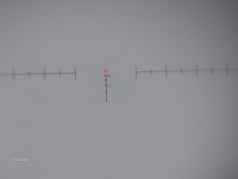

I love my TA31 RCO M4 worth ever penny! The BAC is the cats ass. I have it mounted on a Larue Mount(LT100), also worth ever penny. If you want one you'll have to go to the states as there are none in Canada any more(not sure if there ever were any up here).
Here's mine
I've got a bunch of questions. How close is the scope calibrated for distance? I mean it is designed to use 5.56 military rounds but how close is it with .223? I take it you're supposed to zero it at 100yds if so how far off is it at 400yds? Or have you had the opportunity to shoot that far yet? What part of the reticle do you use for 200 + 300yds What bullet weight is it used with 55gr or 62gr? And how is it for close combat type shooting? Is there too much magnification to use it indoors at a 25 yard range? How does it work at closer ranges like 15 or 20 yds? Any input would be great!
the scope above is calibrated for the 62gr army round out of the 16"bbl M4 rifle that the marine corp is adopting..... using milspec ammo the bdc should be right on.
as you can see in the picture it is marked for 100-400-500-600-700-800 yd markings right in the reticle.
US mil spec for its 62gr should be around 3100 fps from a 20" bbl..... +\-
The tip of the chevron is 100m
The inside tip of the chevron is 200m
The red tip under the chevron is 300m
The rest is marked for 400,500,600,700 and 800m down the line.
Also the chevron and hash marks can be used as a simple range finder by placing the marks on a mans chest and the one that fits is the range of the target.
As for CQB this scope has the BAC option on it so at close range with both eye open it acts like a no magnification red dot sight. It's hard to explain so here's a link to how it works with a demo
http://www.trijicon.com/aiming.cfm
Thanks a lot! Very helpful. Does anyone know what the hash marks to the left and right of the chevron are used for?
