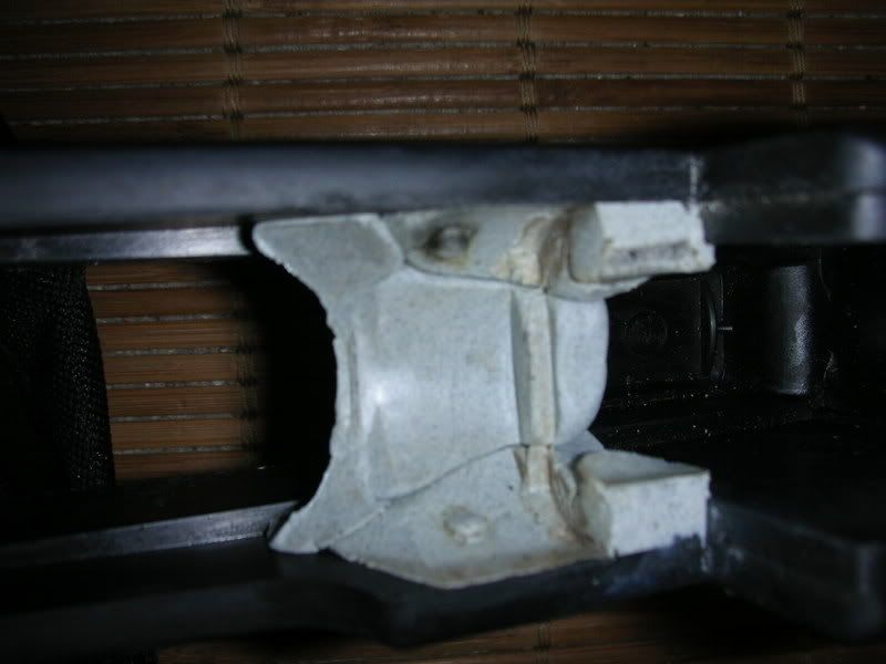

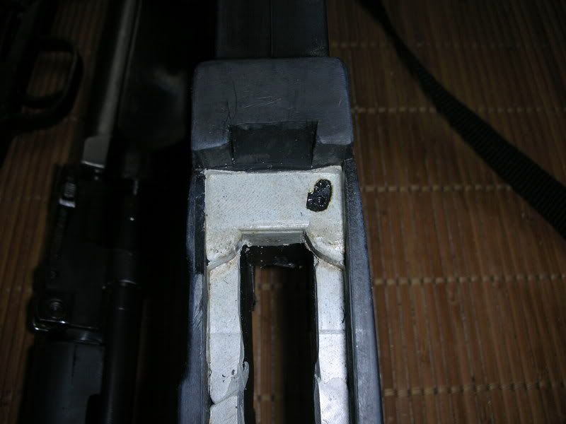

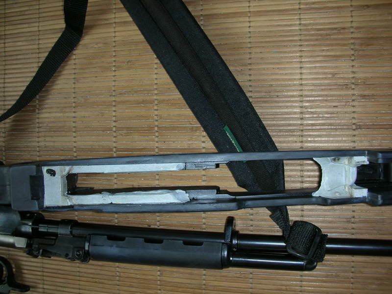

This is my plan as well, in fact there are pics somewhere in this forum of a bedding job done w/JB weld and car wax as a release agent, looked pretty good and probably strong as helldh79 said:If you just want to make it better I'm sure fiberglass could do the job. If you want to do everything as best as possible, acraglass (or some other bedding compound) would be the best. I've heard of many people using jb weld to for bedding compound. On an sks I would not lose sleep over using jb weld.
poweredbybeer said:This is my plan as well, in fact there are pics somewhere in this forum of a bedding job done w/JB weld and car wax as a release agent, looked pretty good and probably strong as hellAlternately, I've also drilled & tapped a 10-32 hole through the back of the trigger group (about 3/4" aft of the trigger group latch) that goes up through a hole in the stock and threads into the reciever. I'll take pics sometime so I don't have to sit here and explain it
Cinches up the action REALLY tight, no movement whatsoever. Now I just need to bed the front ferrule, and ideally I'd like to put a bolt through the cleaning rod hole into a gob of JB weld or something, in order to hold the front ferrule securely as well. Work in progress...
I found exactly the same thing with my Fiberforce stock. I suspect the front ferrule boss is made intentionally too long, in order to fit the sloppy tolerances of most SKS's. I rasped/filed the front ferrule area of the stock until that 1/8" gap at the "ducktail" behind the reciever disappeared, now the barrel & action just drops in easily.Ripstop said:One question. Do you find that the bolt cover takedown pin doesn't line up very well with the stock? That the rifle would fit the stock better if it were sitting back that 1/8 of an inch? I found that I had to trim a bit off the front of my synthetic stock to get it to fit right. When I put the rifle together, I could see that the front ferrule didn't sit down flush. I figured that there was a little extra flash from molding. Now it all sits in there very nicely.
