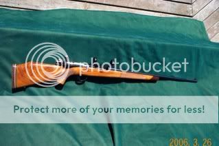

Sorry I sold this one it was a shooter original .257 Epps Improved made by Epps, lucky Gunnutz member has this one very pleased as well.
You just fired .257 Roberts to make casings,
