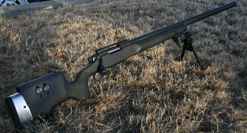

Karsten ships to Canada - no issues whatsoever. $65 and here in 3 days, and about 5 minutes for install. It's solid and work's fine for the $$. This one is on my HS precision stocked 338 lapua. No complaints from me, but obviously a big difference from the real deal that ATR would install.

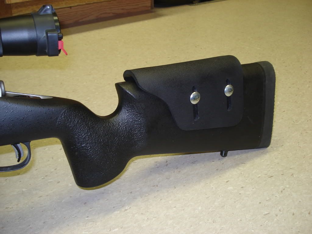

Here's the one I made. Not to hard to do and cost about $8 in materials. I'd like to have the proper McMillan cheek rest but at 15 times the cost this will have to do for now. (More money for a good scope)
Still need to paint the cheek rest and bolts but it should look pretty good when I'm done. It is a bit of a pain to adjust though (compared to an HS), but when it's set, it's very solid.
I'm going to try another one, and this time mill out an area to glue in a thin strip of rubber where the cheek contact is made. If it works well it should feel a little better than the hard plastic. Still it’s not nearly as good as an HS or McMillan, but it's a bit more affordable solution to the same problem.
If you have any questions about making them or if you want to have me cut one out and mold it for ya(only takes about a half hour), shoot me a PM.

I got one a while back from Karsten. Shipping was fast and the unit went on easy. Just make sure you allow not only enough room for the bolt to travel but extra for bolt removal. Im quite happy with it.
