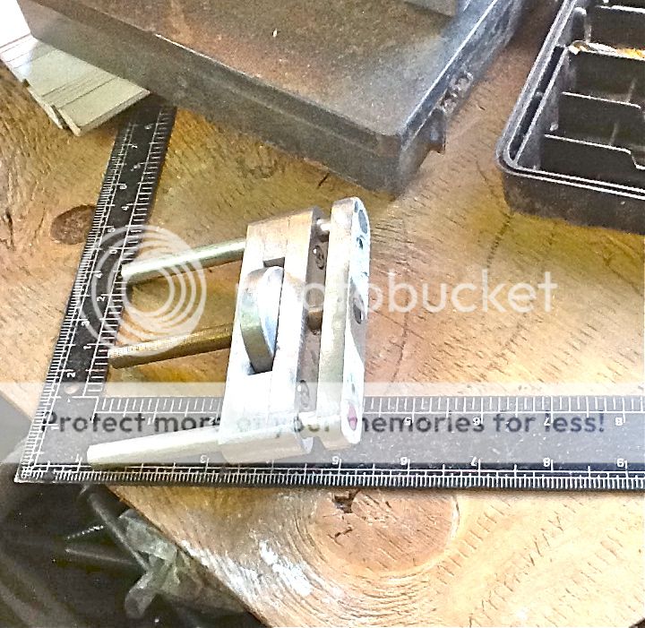

was thinking about building adjustable cheek rest and lop on a stock at some point, I scratched this together in the garage out of aluminum and threaded rod, I'm not a gunsmith and I dont have the fancy tools associated with it. Was bored the other day...
This was more of a prototype, just using cheap grade aluminum, I think I want to redo it using 6061-T6 or 7075 rods, as these don't seem like they have the strength needed, what I used is 3/8" but thinking maybe for the same style on a rear adjustable section I'd use 1/2" and a larger diameter of threaded rod.
For those of you who have built something similar, do you have any design input? I think this sort of design for LOP would need to be quite a bit stronger, maybe use a steel thumb wheel and a steel plate for the section that bolts to the butt pad.

That looks very similar to what I made a few years ago. I don't know why you think you'd need 1/2" rods unless you're a gorilla. I made 2 of them, the second one eliminated the 2 parallel rods to permit the but pad to rotate left/right for prone/sitting positions. I then used just a threaded central rod for LOP adjust, rotate and a side grub screw to lock the rod. I'm really surprised that your pic looks almost identical to my first.
