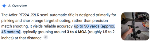

Adler RF224 + RWS Rifle Match @ 50 Yards – Averaging 3.96 MOA, Normal?

I know the ammo could be the problem, but I don't think they affect the group size that much, probably less ~.5MOA. for a 12" barrel, I would expect 2.5MOA group.
But I will check the barrel screw and rings, mount and maybe the wind is the culprit. Thanks a lot.
Problem may be that you are feeding premium champagne to a "Lucky Lager" rifle. Basic ammo likely won't make much difference to your groups, but you will be saving some money.
I have read various reviews, 2-5 MOA at 50 yards seems to be the norm (a little better or even a little worse than AI is suggesting). Your rifle seems to be shooting a bit better than the on-line reviews would suggest, a Savage 64 for half the money will usually shoot below 2 MOA at 50 yards. Your rifle is not a CZ or an Anschutz, it is a Turkish lead-spreader:
I will pick a calm day to do another round test.

Now I finally understand what you meant. Right after I took the front barrel nut off, I noticed that the barrel wobbled like a ####. The barrel is only held to the receiver by only one screw and needed the front barrel nut tensions handguard and barrel together.
That's the most awkward design I have ever seen.
You are right about this and the Derya TM22 does have a front barrel spacer between handguard and barrel, but at least not screwed with the barrel together.
Finally had time to test it out again in a calm day.
But before that, like what I mentioned in the last post, I had to re-install the barrel because it was loose from the factory.
Short answer, it's not really getting any improvement. Shooting the same ammo: RWS Match still got 3.82 MOA, which was slightly better than last time - 3.96 MOA. But with Federal AutoMatch, it can get 2.94 MOA in average and 1.94 MOA for the best.
If anyone needs more detailed group information, you can go to this website and check them out: https://scanmygroup.com/en/guns/4/adler-rf-224-utg-bugbuster-3-9x32.
You are also very welcome to post your groups there.
