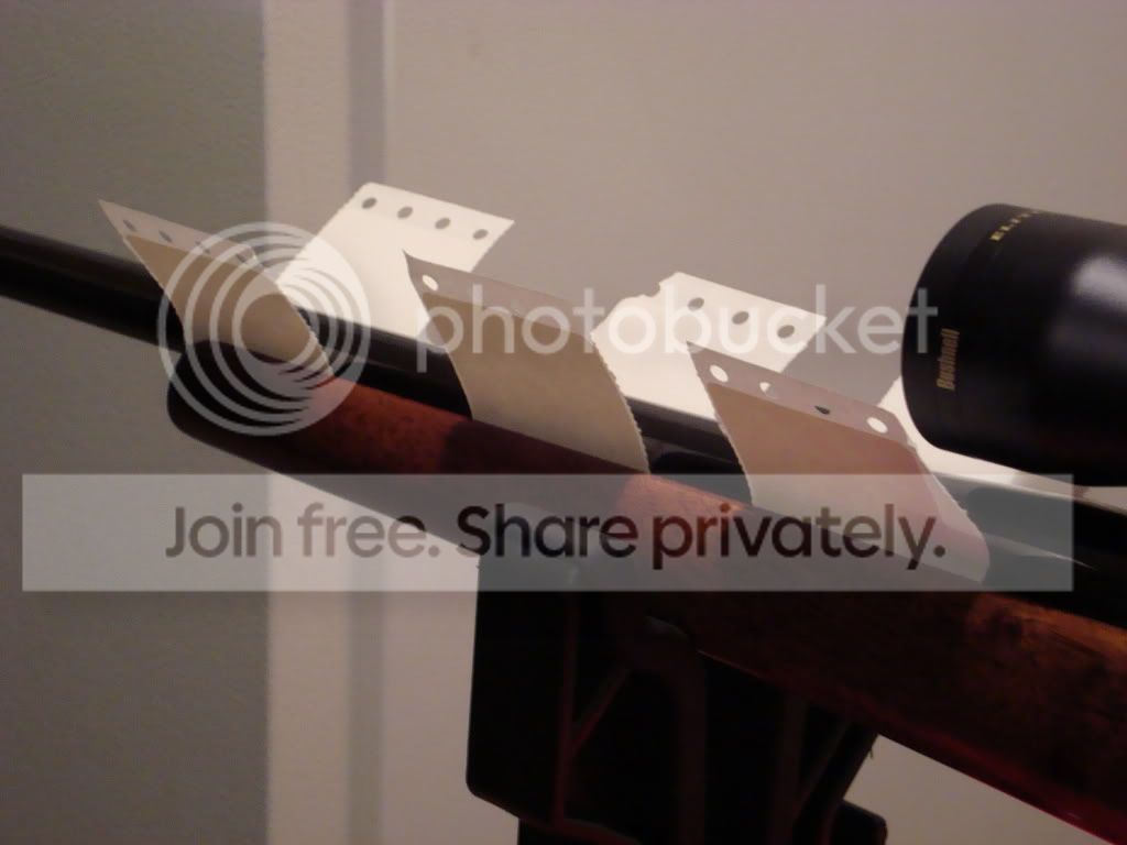

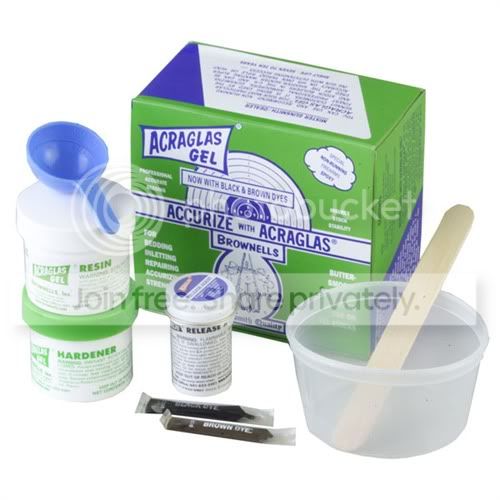

I wish I was smart enough to start right off the bat with a floated/bedded gun. But I'm dumb and I try to make it work, then bed and or float and say "#### I shoulda done that right off the bat..."
Its like 30$ for an acraglass kit. 15$ for a jobmate dremel. Go to town, don't be shy. If you screw up just dremel it out and do it again :)
I've bedded a few guns but am hoping she'd be ok without. This gun has a synthetic stock. Any issues with bedding on synthetic as I've only worked with wood ?
I would open up the barrel channel and try that before doing anything else. I only like to make one change at a time, if that works great. If more work is neeeded then glass bed maybe add pillars.
At least float the barrel. If it still strings, then bed it. I have had rifles go from stringing to nice little sub-moa triangles, just by floating the barrel. Likely the stock has a pressure point under the barrel that is pushing up as it heats up.
