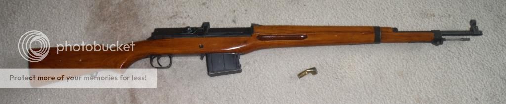

Hi all,
I felt I would share with you all my most recent experience at my latest range trip.

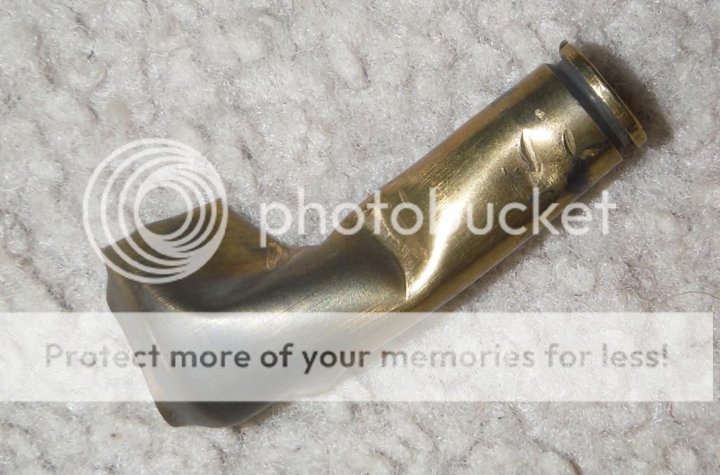

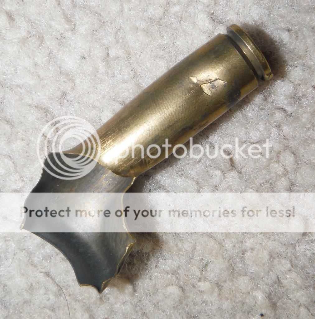

Yesterday I was shooting my new to me AG-42b and I experienced a out of battery detonation. The rifle doubled (or tripled not sure how many rounds were fired) in full auto for a second and one of the rounds it fired was about 1/4 to 1/2 inch out of battery. The rifle then dumped the gasses down the magazine well (like they are meant to in these type of situations) and blew off the bottom of the magazine and the magazine spring (follower was held in place by the pin in the magazine). No one was hurt as the rifle functioned as it was supposed to (well in regards to a out of battery failure), and the rifle was also surprisingly completely fine (no damage done whatsoever) which speaks volumes about the quality of the firearm. After taking a look at it (a qualified gunsmith was also on the range at the same time and he took a quick look as well) and verifying nothing was wrong I continued shooting except as single rounds (the rounds were getting stuck in the chamber anyways we figure due to higher pressure rounds then the original design which was the M94 6.5 Swedish).
The rifle is pretty accurate though, and even though it did full auto for a second all the rounds were on the paper.
Here is some photos (the rifle is pretty much like new) of the rifle and the case that was fired out of battery. Remember to wear eye protection as accidents do happen and always verify the safety of a rifle before you shoot it.

If a round fires when partially chambered, it tends to separate, blowing the casehead off, with a clearly defined ring showing where the cartridge was when ignition occurred.
In your photos, the case is ripped open, and doesn't seem to have been in the chamber at all.
What happened to the bullet? Where did it go?
Just Federal and S&B 6.5x55 (detonation happened with the Federal). The rifle has proper headspace, all the other brass proves that. Apparently the Swedish used to oil the M41 ammo (but not the M94) as it would aid in ejecting the M41 ammo as it ran at a higher pressure.
If you look at the case, it neck sized on the very tip of the case (the gunsmith pointed this out). All the bullets from that group ended up down range on the paper so the bullet travelled where it was supposed to.
I wonder if the breech was able to open while residual pressure was high enough to split the case when it was almost completely extracted.

Also I am not sure if this matters but the other piece of brass from the burst had the primer completely blown out of the socket.
