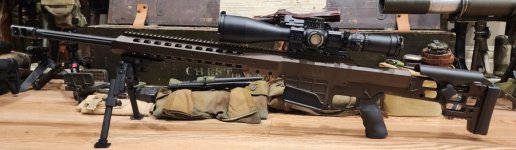

Not on your list, but definitely worthy of your consideration is the Barrett MRAD, distributed in Canada by Wolverine Supplies. This is the easiest and quickest switch-calibre system available, allowing you to shoot a broad variety of calibers, ranging from 6.5 CM to .338 Lapua and Norma Magnums. A calibre swap takes literally 2 minutes and requires the loosening of 2 screws retaining the Barrel Shank.
The MRAAD has been adopted by US Special Operations Command as their Advanced Sniper Rifle, after an exhaustive double round of testing against all designs with similar capabilities. Subsequent to the USSOCOM selection, the US Army adopted the MRAD as its primary sniper rifle, designated the M22. Most recently it has been picked up by the US Marine Corps. In all cases, the MRAD/M22 replaces all in-service bolt-action sniper systems, including the US Army and SOCOM M24, the USMC M40, and the M82 Barrett .50 cal semi-auto sniper rifles in service with all branches of the US Military. There is some pretty significant praise for the Barrett product from end-users in the field as well!
I just picked up this lightly used older model (no MLOC slots in the Handguard), set up for both 6.5 CM And .338 LM. A new rifle is $9K and a caliber conversion is $3.5K (CAD), so $11.5K CAD for a brand new 2-caliber setup. I paid $8K for my example, so clearly, there are some savings to be had if you can find what you want on the used market...

...... Bartok's example is the first gen, you need a modernization kit from Barrett if you're going to shoot any of the new caliber kits......
Can you please elaborate regarding this Barrett Gen 1 to Gen 2 "Modernization Kit"? Barrett's online store doesn't sell anything resembling such a kit, aside from the Adjustable Buttplate Upgrade. I could not find any reference to such a kit perusing both the old and newer versions of the User's Manual. To the best of my knowledge (which is certainly NOT all-encompassing), the only "upgrades" to the Gen 2 MRAD were the aforementioned vertically-Adjustable Buttplate and the inclusion of Handguard MLOK Slots to replace screw-mounted Handguard Rails for accessories. I am curious what internal changes were made that require this "Modernization Kit", and what exactly does it entail? I have no need for additional caliber conversions, but may require a replacement for my 6.5 CM tube some day....
Sure!
https://store.barrett.net/p-3587-mrad-breech-conversion-kit-large-to-small.aspx
Basically they changed the breech size so if you're going to buy any new barrel or caliber kit you need to make sure you have the small breech version. There's some talk about it on snipers hide. I believe the bolt heads are slightly different too if I'm remembering correctly.
If you've shot both then chanced are they are made for your gun. But a new one, as well as if a smith spins one up for you, if they are running the new specs it'll be different. Not the end of the world though. only $475 USD
Sure!
I already have that Large Breech to Small Breech Conversion Kit with my 6.5 CM Barrel. I have the Large Breech Kit for my .338 LM Barrel. In other words, each of my Barrels has a complete Bolt/Carrier Assembly and its own Polymer Inserts. The web-site says that this kit is required to change from small/short calibers to the major calibers such as .338 if you happen to own a Gen 1 rifle. Hence, my rifle already came with the Conversion Kit.
I am not convinced that the Conversion Kit is necessary to use newer Barrels in older Rifles. Rather, the kit is for use with older rifles (such as mine) when switching from "major" (eg. 338 LM) to "minor" (6.5 CM) calibers. That is all. I am not sure where you got the idea that the conversion kit allows the use of newer Barrels in older Rifles, but I think that you may be mistaken there. The older Gen 1 Rifles basically just require 2 sets of guts (one of which is the "Conversion Kit"), to cover off the entire spectrum of Barrett calibers.
Equipped with both sets of MRAD innards, I ought to be able to use any current Caliber Kit consisting of the applicable Bolt Head and Barrel in my Gen 1 rifle.

The Barrett MRAD. I looked at these, I really looked at these. The reason I didn't go this route were the different Gens, requiring a conversion piece if you have an older gen along with the lack of calibre conversion kits. Most of the MRAD rifles I saw for sale, came with one calibre. But looking around, I couldn't find kits to add to it. There's not much point in having a multi calibre rifle with only one Calibre. Also I like the looks of the Gen 2 with the Mlok rail. Reminded me of my LMT MRP rifles. However, there were reported incidents with a batch of mil contract mk22 which also included some of the rifles bought in the Civilian market with the handguard/upper receiver cracking. Knowing my luck, I'd end up with one. Considering I couldn't even find conversion kits, I had little to no faith in any support from Barrett. If you can find a good one with multiple calibres, then this rifle would likely make you happy and is a contender with all the others mentioned. Cool rifles, although looks a little too much like a bolt action AR10 to me. But.. had I found one that was perfect, I would have likely bought it.
