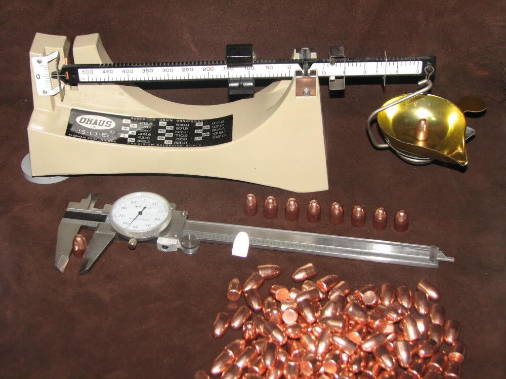

Just received my first purchase today of AIM Bullets in 124gr 9mm I bought from a site sponsor and thought I would do a little consistency testing and bullet sectioning. Considering they are handgun bullets and excellent value for the price I am so far impressed. Haven't loaded or shot any yet but I am expecting pretty decent results. Chose 10 random bullets to test, here are the results:
1. 126.0gr .575 oal
2. 126.0gr .576 oal
3. 126.5gr .574 oal
4. 125.8gr .574 oal
5. 126.0gr .575 oal
6. 125.6gr .574 oal
7. 125.9gr .575 oal
8. 126.1gr .576 oal
9. 126.8gr .576 oal
10. 125.8gr .575 oal
All bullets measured .355 diameter.
Plating thickness seems pretty good also. I expect I will be placing another order in the near future.

Did some more measuring/weighing on another brand of 124gr 9mm bullets I had (not sure of manufacturer) and these were the results:
Weight/Diameter/Length
1: 124.2gr 3.54 5.78
2: 124.2gr 3.54 5.78
3: 125.5gr 3.55 5.82
4: 125.0gr 3.55 5.78
5: 125.0gr 3.55 5.80
6: 124.5gr 3.54 5.78
7: 125.5gr 3.55 5.81
8: 124.9gr 3.54 5.80
9: 124.3gr 3.54 5.78
10: 124.6gr 3.54 5.80

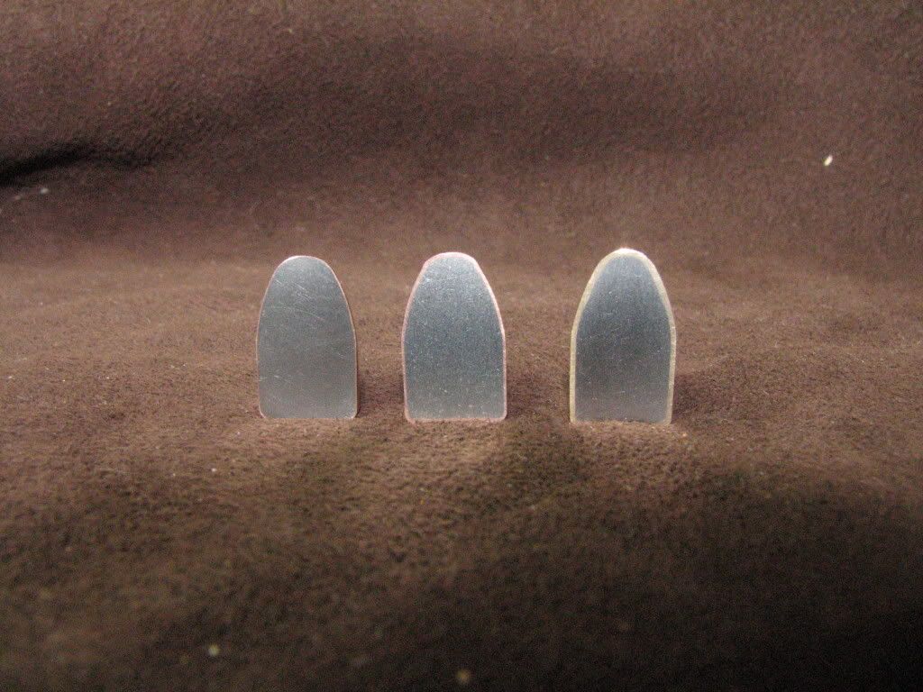

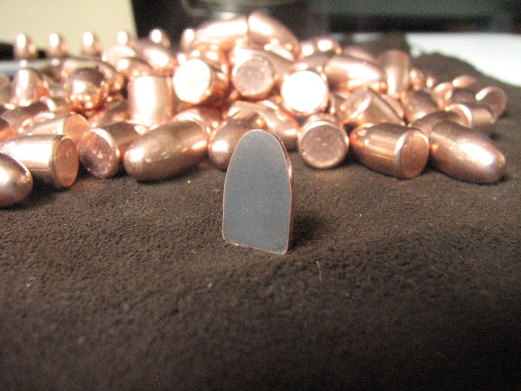

So Aim is definitely as consistent if not more consistent than these. I sectioned a couple more, the first being AIM, the second from this test, and the last was an undamaged fired bullet I picked up at the range (Montana Gold?) The thicker jackets on the last two I would think to be of no benefit for target shooting, and with the good prices on Aim bullets and them being Canadian also I can't see myself spending my money on an American suppliers bullet again when we have a quality product right here at home. Don't know if anybody else gives a hoot about this stuff but I personally find it interesting, especially figuring out how to section a bullet respectably.
I took a piece of hardwood (walnut, was all I had) about 3/4" thick, bored a 9mm sized hole in it about 3/4 of the way through, pushed the bullet into the hole, then proceeded to cut the wood and bullet with my table top wood bandsaw (copper and lead are soft so the blade survived), but never cut the wood full length so it still held the bullet. I then ran the face of the sectioned bullet against a file, then 120 grit, then 240 grit, then oiled 400 grit and finally oiled 600 grit. I plan to section many of my rifle bullets also just for fun, kinda interesting to see the construction.
