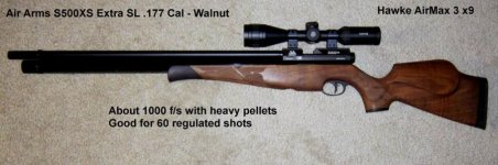

I have found the 10.34 grain Exact pellets shoot really well out of my PCP at max pressure. That's what I will be using in this springer... probably around 900 f/s. I'll run it though my chronograph and see what it is.

Velocity wise it shoots the 10.34 pellets at 700 f/s, the 8 grain pellets at 730 f/s, and 6.5 grain pellets at 870 f/s. My PCP shoots the 10.34 at 1000 f/s.
