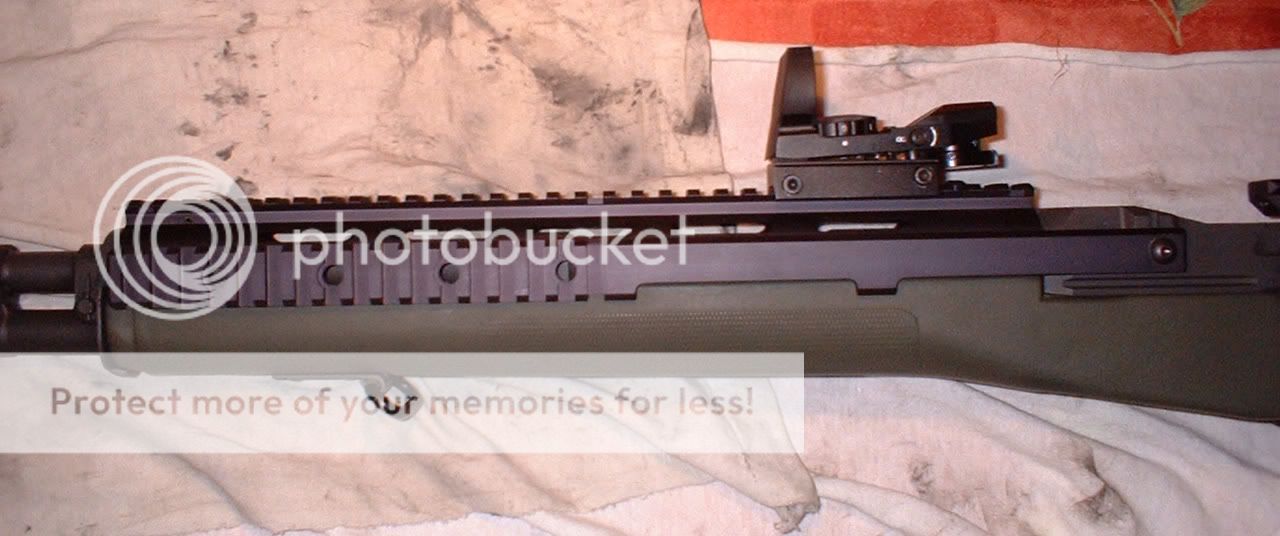

Here's an update with pics of the King Arms M14 RAS.
First off, i found from the Sadlak website that the receiver scope mount hole (left side) is threaded #12-32 UNEF-2B with hole ID of .182/.186
What that means is that it's a wierdo screw... can't find it at local hardware stores... will try tomorrow at a car garage shop.
I also emailed KAC to see if they can send me a replacement screw (i also asked for the rear scope base that attaches to the clip guide... you'll see why in the pics below...). Waiting their response.
Inspection of rails with my poor man's mil-1913 guage (TangoDown VG) revealed that they are a tiny bit smaller than spec... but not by much.
Overall, it doesn't look crappy, as some might think... I've never seen the real thing in person, but this rail is quite nicely done. :)
Bizarre thing is this spelling error: ArmaNent :rolleyes: maybe it was intentional ? anyway, doesn't matter to me 'cause i'll eventually paint the whole thing with Krylon camo.
Top part is gradually cut-out, and that is supposed to allow use of iron sights...
Unfortunately... the top screw is too high; it hides the lower half of the front sight... filing of this screw will be mandatory.
Lower view, showing how the rails stay parallel with the barrel.
There are minor machining marks on the inside. None seen on the outside.
Other view from the inside, showing where the op-rod contacts the rail when cycling... this is another part that needs some filing.
Here's the bits & pieces (it was supplied with two more washers, absent from pic)
Here's the bad side locking screw. It was partially stripped when I got it, but even without the stripping, it would still be loose in the receiver hole... it's probably not the right dimension/threading. Remember this rail is supposed to go on airsoft M14 toys...
Here's a potential problem; the rear mount. It is "secured" by a small hex screw which contacts the receiver, but doesn't enter in the roll pin hole. The dovetail is much too small, there's gaps everywhere... i wonder how it will sustain the recoil :confused: Need to live-fire with scope mounted to judge this. It's made of aluminium, very light... but i would have preferred steel.
Also, there's an bigger hex screw on the bolt side that serves no function that i can think of :confused:
This is still a work in progress...
The final verdict and review will come after i find a good side screw and after firing a few boxes of ammo.
P.S.: I don't see any problem putting a cheap chinese replica accessory on a cheap chinese replica rifle ;)

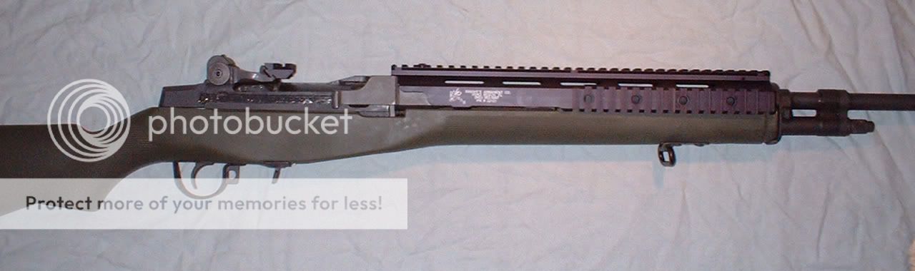

Sniper1, I have the real KAC RAS pictured on my Poly below - your Armanent copy looks like a perfect clone. Very nice!
