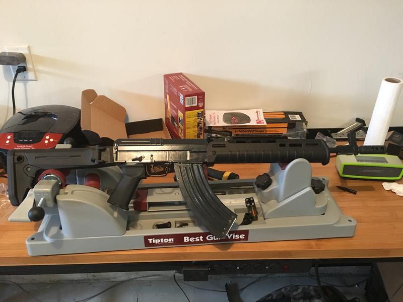

I am mounting this setup on Wednesday on my CZ-858. Now if your planning on mounting this to a CZ, you will notice your sidewalls of your receiver are rather thin. So in my case i am having a friend drill and tap the wholes on a mill. This just ensures accuracy and a perfect tap instead of it wondering off on you.
back when I had my cz I mounted a csa rail on it. Yes the sidewalls are very thin..and you can only get a few threads thru it..not enough for peace of mind. So I tightened it down with red lock tite, then put some nuts on the inside of the receiver and snugged them also...and used red locktite....it turned out rock solid. There was plenty of room on the inside to accommodate the nuts.
But you need to machine out a window for the serial number, you don't want to have to heat it up and remove it....just to verify it..if ever needed
CTCS is awesome :)
I did find something , the top pin is difficult to remove i find that the adaptor is pushing on the spring i just fix it with a dremel , i will send to Scot :)
