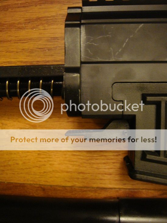

I just received a new replacement shotgun and was told it is a newer generation that should feed more reliably but the extra Gen one mags I have wont fit . Wolverine said they will send out the replacements when they are available.

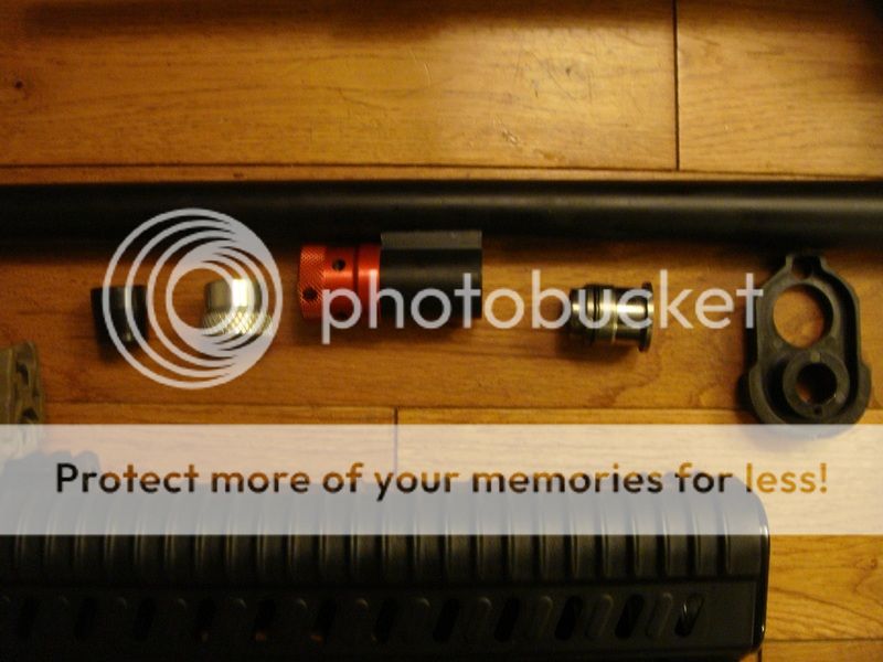

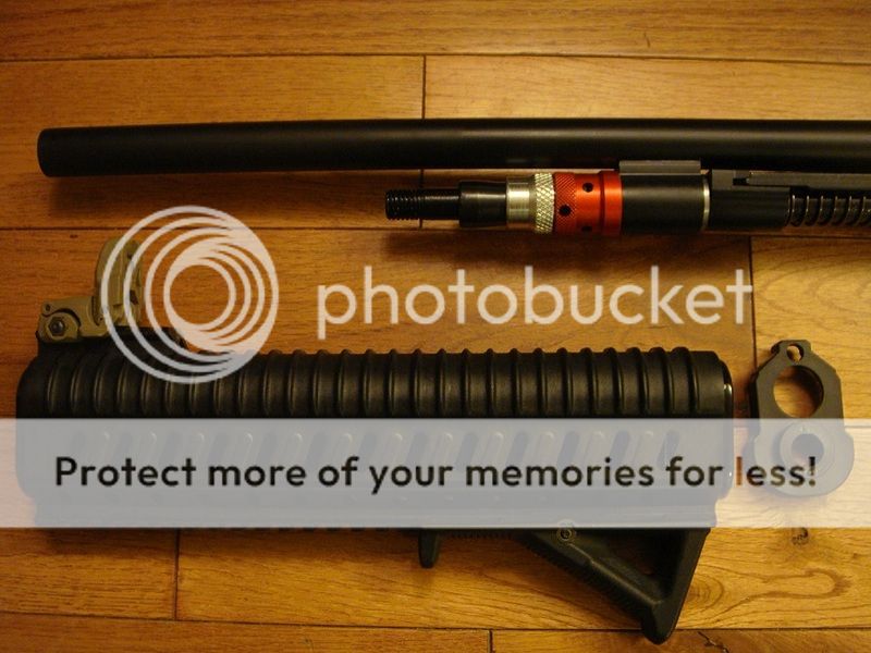

Looking at it quickly the gas system has a red and silver screw on piece for the gas rings and the barrel take down latch is a bit different as it clips into the lock position more securely . The front ferrule that holds the handguard into position is now plastic and the trigger on mine feels better than my first one as well.

I ditched the carrying handle and front sight and mounted the forestock upside down then added a set of magpul BUIS and AFG .
No filing of the upper picatinney rail required this time to get the front sight to slip on. :)

The barrel locking lever secures into position with a more secure locking action now as well.
The new screw on ported gas system and plastic handguard ferrule. The silver part needs to be unscrewed before removing the barrel now .
UPDATE : I tried out my Gen 2 today and it ran 150 shells through it . It ran fine with Challenger 2 3/4 inch Handicap shells but didn't like the Winchester Universal or Federal I brought along .Having the handguard mounted upside down and using magpul sights on the short picatinney rail didn't work as the front sight is then too high . I had the front sight set as low as it will go but it still was hitting over a foot low at 15 yards . I mounted the handguard correctly and then the magpul sights worked fine.
