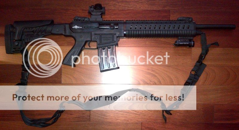

I went with a TRS-25 on a Bushnell high riser.

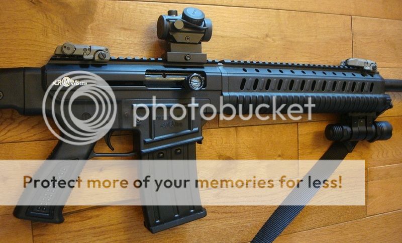

The bolt handle cover (Bugout makes them) works really well. So now my fingers no longer bleed and I can rack the bolt over the top with my weak hand easily. The bolt cover screws on (there are little nuts countersunk in the cover) and I did not use glue so that the cover rotates freely on the bolt.
I did the file down on my rails and attached Magpul BUIS. With the high riser they are a lower 1/3 co-witness. I might try a medium riser.
The light is a TLR-1 LED I had lying around but eventually I'll mount a 960 lumen Fenix PD35 at 9 o'clock off the top rail.
The sling is a Vism.
I did the rail mod to mine this morning for the MBUS ,added the cocking handle cover from Bugout and an old light I wasn't using .
