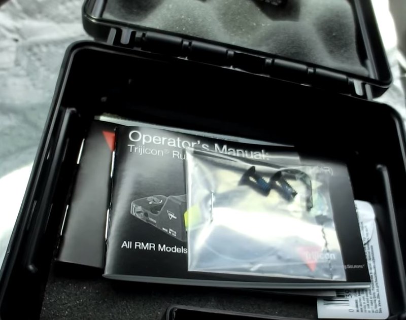

Here is a picture of your package contents for the RMR. The two crews in the bag is what you use to screw the sight onto the mount. If you did not get these, call Trijicon.
