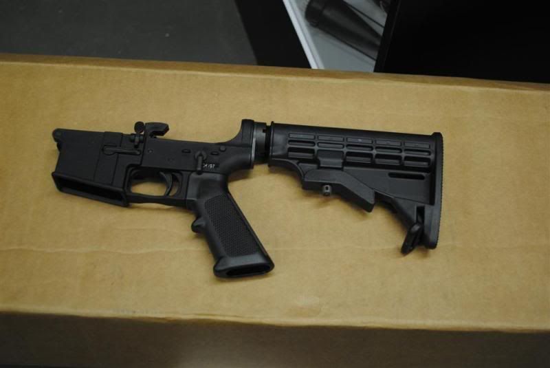

There's a guy on BE selling glass re-enforced AR-15 lowers including the FCG and stock for $129. I believe the FCG is also glass re-enforced plastic.
I think the Carbon 15 flop will keep most people from jumping too fast on the bandwagon.
Those sound like cavalry arms lowers. Were they one piece?

i'd have to wait for some reviews but those plumcrazy's sound pretty bad ass from the website. Light, chemical resistant and not requiring a lot of lubrication. All for about 150$ for a complete lower doesn't sound to shabby.

The lower is under stress only at the buffer tube extension, and at the front pivot point. I suspect these might hold up fine, but I suspect they will suffer from the same failures at the front pivot that the AR-180B experienced.
I'm skeptical, but who knows.

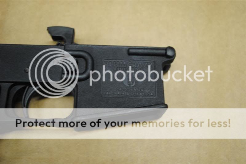

I don't like the plastic FCG, I see the hammers have been getting quite a bit of wear.

I agree that plastic can be used for FCG's and lowers. I would trust the big companies like FN to have top end engineers who would use the best polymers. I just don't have that trust with little companies especially when I have seen the wear the Plum crazy hammers get. Novelty is all I see with this one.
