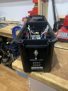

Here it is!
I actually just posted this because I think I finally figured out how to post pics! I was reading the why no posting pictures rant and figured I would try once again. By the way nothing to do with being lazy. Anyway here’s my pid with a picture and all. I’m pretty tecky now.
