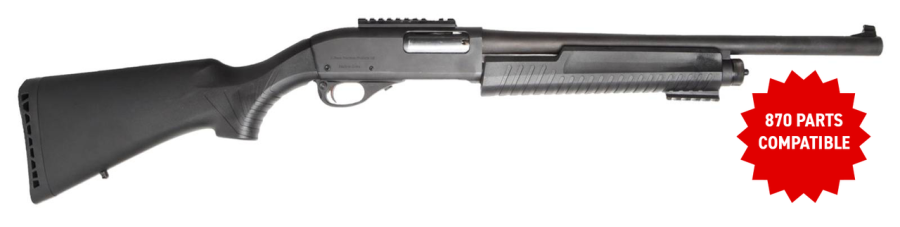

American Tactical Remington 870 clone
American Tactical ..Made in Turkey? Wait, is this actually made in America? The price seems decent enough.
Just registered an account to let you know it's made in China by a sporting goods company called S-Beam Precision Products Ltd based in Guangdong.
I just took delivery of one of these ATI 870 clones.
Some observations:
- Remington 14" police barrel fits but is very tight and the first time I fitted it the action I could be cycled without firing or using the bold release
- Feels lighter than my Remington or my Blueline clone
- Stock feels cheaper than either my Remington or Blueline, also the butt is about an inch longer than the Blueline
- The Blue line looks to be better built and has less plastic (metal trigger guard with more finger room) than the ATI
- The Blue line has better looking metal work though it is not as smooth to action as the ATI out of the box
Lastly, in some ways both the ATI and the Blueline have better fit and finish than a Remington Police 870 that I recently purchased. The Remington is an absolute #### to get the action bars and bolt back together due to burrs and poorly finished metal edges. Both the Blueline and ATI strip down and reassemble much nicer than the real Remington.
HeadDamage - Thanks for the details. Is the receiver steel or alloy? Is it also made by Hawk Industries in China, or someone else?
American Tactical MB3R is a Remington 870 clone
https://sjhardware.com/ati-s-beam-mb3-r-12ga-pump-shotgun-sgp-18-5-bbl-blade-sight-w-rail/
- 12 GA 2 3/4" and 3"
Fixed cly choke
Compatible with standard rem 870 barrles.
Chrome plates bolt and carrier
- Magazine Tube is threaded the same as a Remington 870, compatible with S&J Hardware Remington 870 magazine tube extensions (+1, +2, +3) (+2 will sit flush with the end of the barrel)
- Compatible with S&J Hardware Remington 870 Jumbo Safety
- Compatible with S&J Hardware Mossberg 500 / 590 M1913 Rail
- Compatible with Magpul furniture
