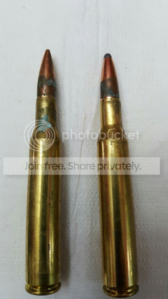

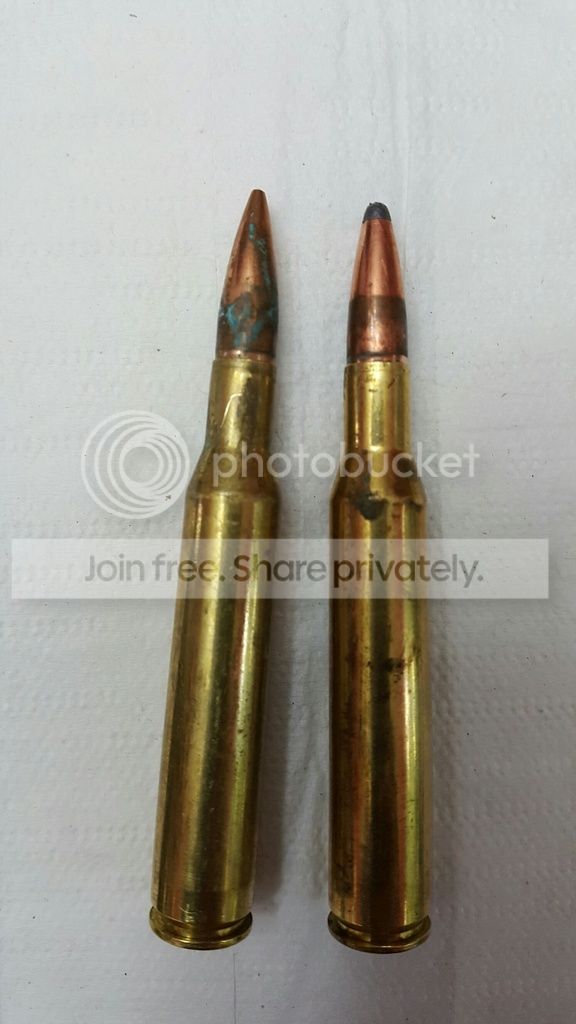

Got back from my hunting trip which we were skunked on for immature moose and a buck mulie, and was putting away my rifles and mags when I noticed that two of my rounds, which had been chambered but not fired, are now corroded. What would cause this to happen? Also, what should I do to properly clean these rounds?
Brass - Norma
150g bullet - Berger
160g bullet - Nosler Partition (lead tipped round)
Rifle - stainless Steyr Pro Hunter .270
I tried to Google this but when you type in corroded ammo, it brings up tonnes of surplus threads and info. I did see a mention of perhaps using Hoppes #9 solvent (which I did use) may be the culprit, but I had fired other rounds down the tube prior to these cartridges being chambered (and one only briefly). Weather was cold and wet, it did snow - but no other rounds have this green corrosion other than these two that were chambered.
Thanks gents.

oxidized copper
Oxidation of Copper and Changing of ColorOxidation is a phenomenon, whereby an element loses electrons (and/or hydrogen) on interacting with another element. Similar to iron and aluminum, the element copper undergoes the process of oxidation, if it is exposed to air. If the atmosphere consists of high humidity moisture, then this process is faster. The copper metal reacts with oxygen, resulting in the formation of an outer layer of copper oxide, which appears green or bluish-green in color. This layer is known as the patina.
Unlike other destructive oxidation processes, the patina acts as a protective layer, and it does not cause any weakness in the metal.
Thus, copper is considered as an important element that is resistant to corrosion.
The patina prevents further corrosion of copper beneath the oxidized layer.
Very often, this layer is seen on the rooftops of old buildings, and acts as a waterproofing and sun-proofing coat.
Cheers
Some left over copper residue got wet and left some goo on your ammo don't worry about it. Give them a wipe down or a green scribble if you want.
Thanks gents - I just cleaned the rifle and after Hoppes #9, I went through the chamber with G96. I'll wipe the rounds down and chalk this one up to experience. Cheers.

Its just my opinion, but those rounds look like they were either in a dirty chamber or a chamber with left over (too much) solvent that never got cleaned out. Toss the rounds into a dry tumbler for 30 minutes and they will be spotless.

I'm going to say that's from a combination of Hoppes #9 residue and a wet barrel.
The only thing I would add into the mix would be oil from your fingers as you take the round out, put it back in the mag, etc. If these were the only rounds you touched a lot with your hand it probably contributed along with the hoppes and moisture
