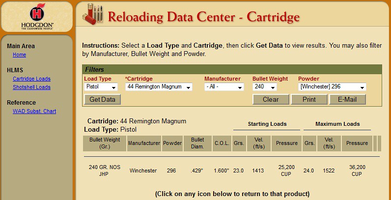

H110 is either the exact powder as W296, or so close that you can completely interchange data.
Many of us use either powder, use same loads and get same results.
+1 on hogdons website the loading data for the loads i use it's always the exact same numbers. it looks, smells, and shoots the same for me.
