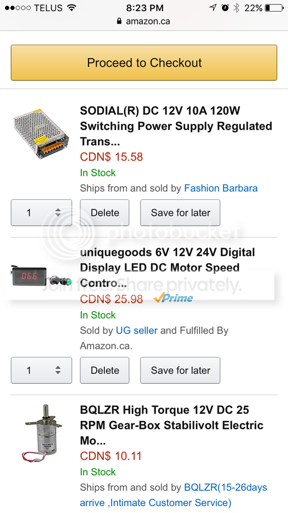

Funny thing, i was researching 12V DC 25rpm motor on Amazon
They suggested me to add a digital controller and a cake pan as it was a frequent combo

Will build same as yours, one less motor, one less control than plan in link
Less hassle to build, and will not reduce annealing speed.

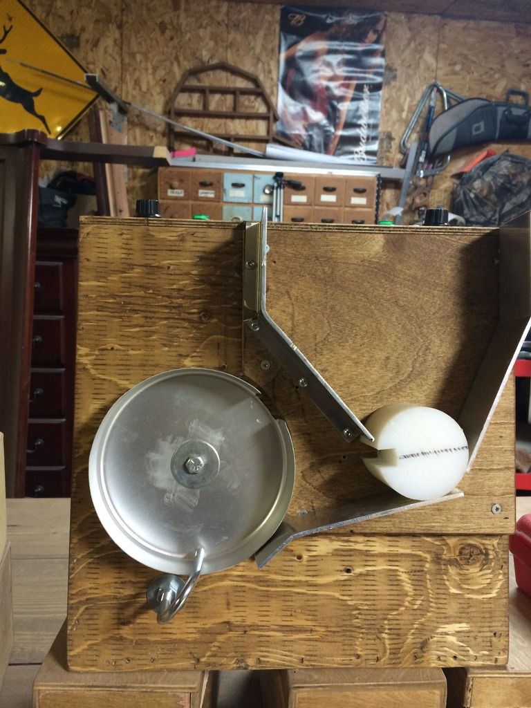

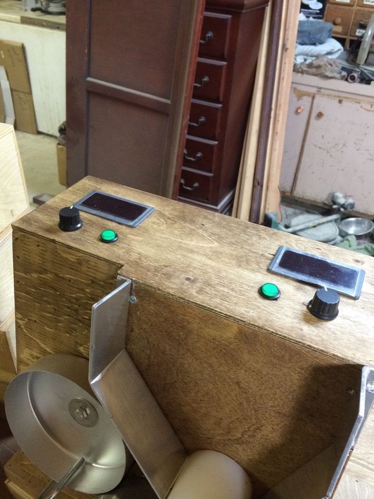

This is my working (but still under construction) annealer:
Aluminum sheet metal was scrap laying around and cost me nothing. I bought two geared motors from Princess auto (12vdc top speed 45rpm), and a PWM from electronics store in Kingston. Wheels I turned from sugar maple. The top motor controls everything except rotation of case in flame: It is controlled through the PWM while the bottom one rotates unencumbered, when the switch is turned on. Torch is a propane/oxygen setup which I only used because it was laying around unused. It makes for quick annealing and preliminary trials indicate that only neck, shoulder and under an 1/8" of a 222 body are actually annealed. The gate is magnet actuated (opposites embedded just ahead of the feed notch in the upper wheel), gravity not spring retained.
It's supposed to do everything from 300 BO to 338win mag, as that will cover everything I foresee wanting to anneal in the next few years but still working out some bugs: The distance between the wheels has produced some issues in reliably dropping 222 cases. This has only been an issue since I put rubber bands around the bottom wheel to increase friction: I did turn a groove for a rubber o-ring for that purpose, but itching to give it try improvised. (the brass bounces sometimes and stands up only to roll off. I resolved the issue with brass overcoming the gate counterweight simply by reversing the rotation of the bottom motor. The most irritating bug is the hopper: Given that the angled sides are not steep, jamming of larger cases occurs. With the little adapter, 222 size cases feed brilliantly. I may rethink that, and increase the angle so the wider 338 belted cases don't work against each other to dam the feed wheel.
