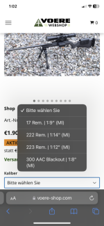

Was wondering the same re: twist. Looks like it’s 1:12 according to the link below. If it was faster like 1:8 I’d seriously consider buying one.
Click on the drop-down menu titled “Kaliber” and it says .223 REM / 1:12”
https://www.voere-shop.com/shop/VOERE-S16-mit-Stahlauf-S16-Sport-Vollausstattung-p477934528
Screenshot:
EDIT: I see its a 1:12".You will find the carbon wrap will loose accuracy the more you shoot it. You have other heavy barrel 223 that will likely out shoot your carbon barrel 223. Light is nice for a while.
