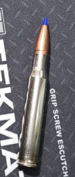

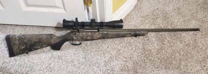

My .25 moa load in my 22 inch T3X SS is:
175gr LRX 55.0 grs RL17, 2880fps OAL: 3.31
My fav hunting rifle ...
N540 is great for 150r bullets ...
N560 for 175/180s ...
If I run out of RL17, I would go to N560

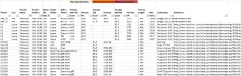

Thanks! If I get velocity like that with accuracy I will be very happy. Trying both powders this weekend. Hoping for the bestMy .25 moa load in my 22 inch T3X SS is:

Never used n560 but I thought it was tailored more towards the magnums ?My .25 moa load in my 22 inch T3X SS is:
