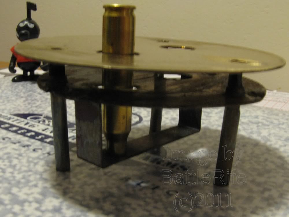

For those thinking of reconstructing my setup, I maintain the case holder is the most important part of the setup. Without a heat shield, you cannot work over the bath without experiencing painful radiant heat on the knuckles. It also controls the level to which the case is immersed. I made mine from thin stainless steel sheet and tube, GTAW welded together. But one guy down in the US who copied my setup told me he built one using threaded rod for the "legs" and jam nuts to hold the shields in position.
Note that with mine, the legs don't function as legs, they serve to house the thermocouple (when I use one) and position the shields. The holder actually hangs in the pot, supported by the larger diameter shield on the pot lip.
