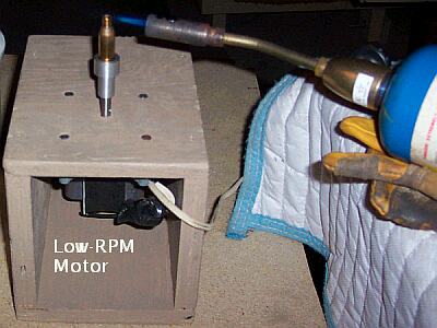

I am making a machine similar to the one below. I will only be doing it on 308 brass. Its not that I am really concerned with the cost of wrecking a couple cases, just want to know the most effective way to know that my time spent in front of this machine payed off. I have seen alot of youtube videos of people WAY OVER annealing a piece of brass, and others that aren't heating the brass even close to long enough.
I use the socket and drill trick
Choose a long socket that fits the case properly, allowing it to turn but not tight.
turn the case above the flame with the drill, then dump in a pan, then start again.
Takes approx 8 seconds for a 300 winmag case neck.
you will see the line going down the neck, stop when the line is at the shoulder. You do not really see the case glowing.
I've seen numerous youtube videos of people completely toasting cases.
just read this and do it. no need to piss your pants really, just do it properly.
