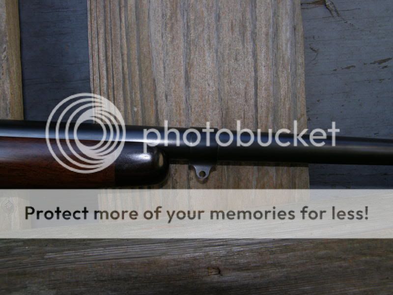

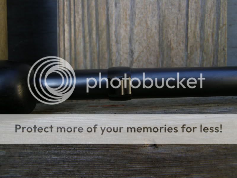

This one is a 9.3X62 Mauser built on a JC Higgins(FN Mauser) action with a 21' Heym barrel. Other than lapping the locking lugs/seats and tapering the rear tang, nothing has been done to the action. The safety is factory and I'm using a Timney trigger. The rings and mounts are Talley holding a Leupold 2-7X33. Total weight scoped is 8lbs 6 oz which is just about right for a rifle in this caliber. All the metal was finished with a slow rust blue.
The stock is unique in that it a English Walnut laminate. Our local gunsmith gave it to me because I'm such a nice guy
. It was configured as a target stock with a huge beaver-tail forend, roll-over cheekpiece and a very generous grip. It's total weigh was well over four pounds. After inletting and bedding, a few minutes with a bandsaw on the forend and roll-over and a few hours with a rasp reduced the weight considerably.
The forend tip, grip cap are ebony as is the trim around the bolt stop. The recoil pad is a 1" Pachmayr Decellerator and the swivel band and stud are from Gentry.
