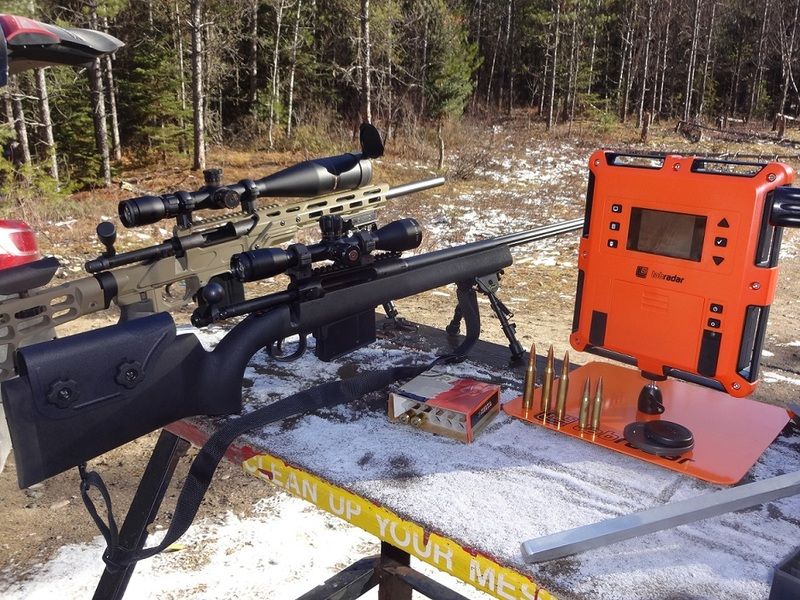

Thanks for the help in getting ours Tod , I picked up our clubs new Labradar and went out to a local spot today to try it and am very impressed with it .The info was easily accessed and saved on my PC later ( Temp -10 C ) .
I shot a couple different calibres ( 243,308,338LM ) and renamed the files later .It was giving me the velocity every meter or so .
The manual mentioned max effective range for tracking is 308cal -80-100 yards ,
5.56mm -40-60 yards , 9mm 100 -130 yards
