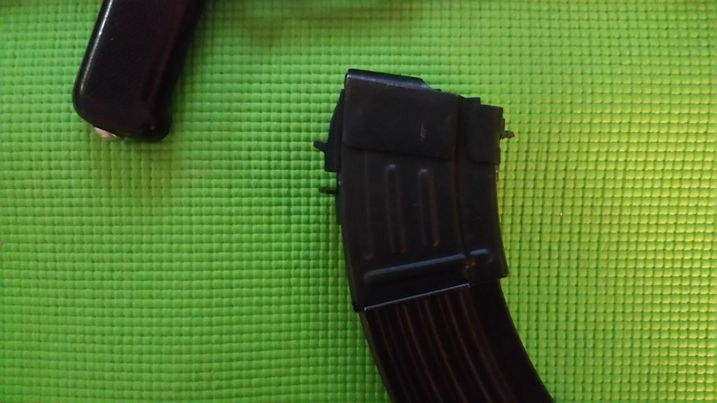

I made up an AK style magazine for it. I looked at my 5 round ak mag but I just didnt see an easy way to make it work, so for now I will be using Steel Promags with the duckbill cut off and an "L" welded on. I will include a picture of the mags, and a pic of the AK mag on top of my modified mag.

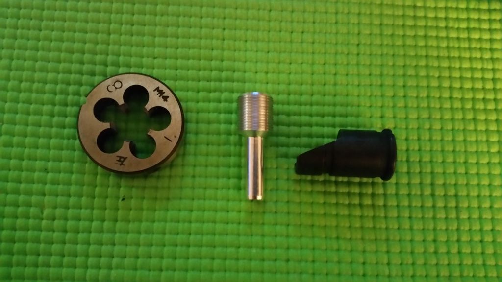

I also picked up a barrel threading kit from ebay. I bought an AK muzzle brake last year that will go on it. I plan on taking off the 2 inches I can legally remove, cut off the bayonet mount and move the front sight back and thread the barrel. This should make the end of the gun look much better.

Short update, I had it to the range yesterday and my magazine isn't feeding properly. I'm not sure if it is a Pro-mag issue or not, I think it just isn't tipped up enough in the front. So I will do some reworking to that and see if I can get it to function better. It feeds rounds from the left side of the mag fine but the right side jams. I also suffered one light strike on the primer, may have to build up the hammer face a little more.
I had noting but issues with steel promags...
I have read a lot of issues with them but honestly I have put a couple hundred rounds through these mags without any issues until I cut the duck bill off. But I could have just been lucky haha.

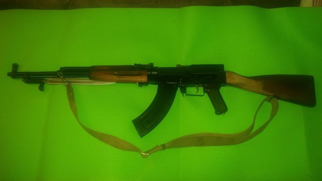

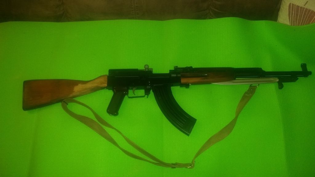

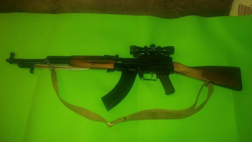

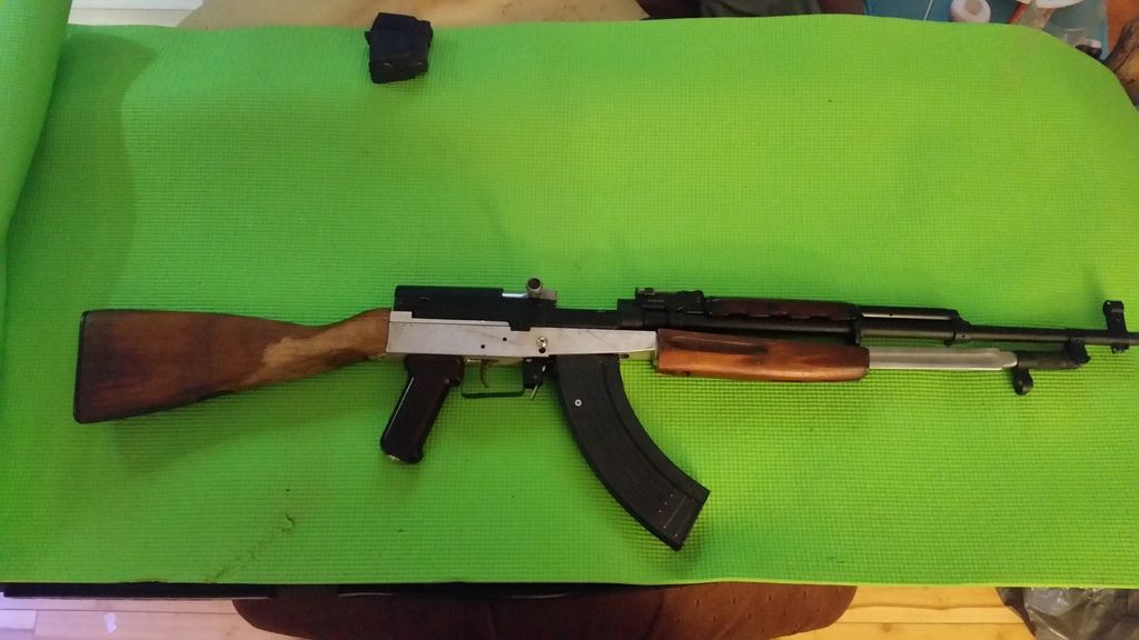

That about covers what I can think of right now, so enough talking heres a few pictures of how it looks today.
Oh yah man, that does look very good..........very good indeed !!
You should stand back,have a good look at her, and be proud of your accomplishment.
I love it.
