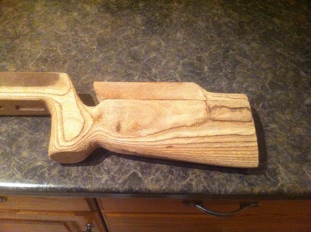

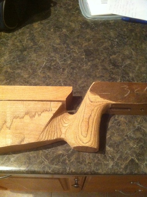

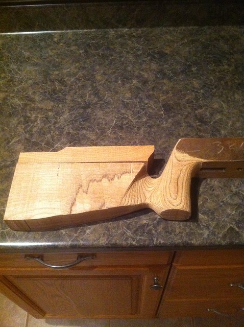

While I was waiting for my barrel I decided to get the butt ready to inlet for my cheek piece riser. So here we have the profile cut:
And here we have the cheek piece separated.

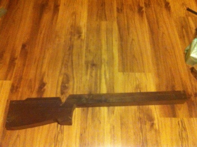

Just a little more progress. I started shaping the grip area. I'm leaving the forestock square until I mill the spot in for the rail.
Looks really nice but what caliber is it for? The stock looks kind of thin behind the grip.

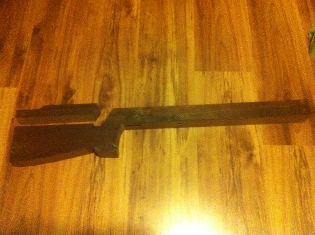

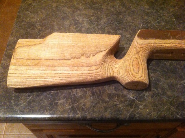

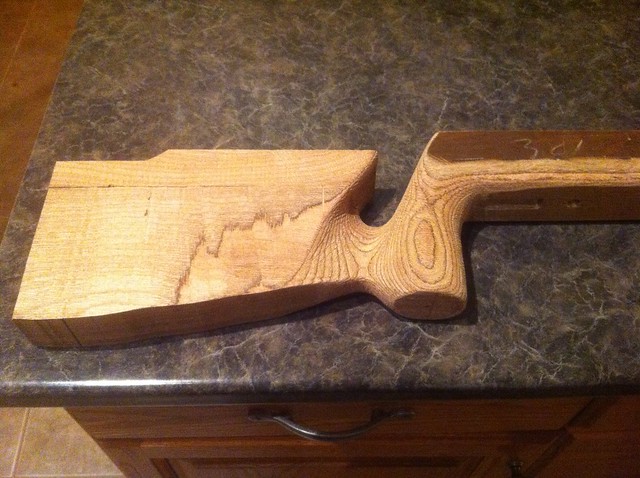

Just did a little bit more shaping along the butt of the rifle. It's starting to take the desired shape. Slow going with a rasp and a straight edge.
There's still 1.5" left to cut off the butt, I just like to leave the excess on there as long as possible to avoid damaging the "real" end.
Looking real good. If you ever have to remove a lot of material in a short time, try a hand-held grinder with a 50 grit paper. This is how I shape my stocks.

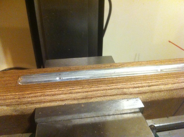

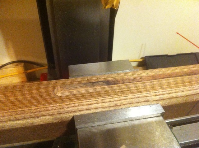

Well tonight I got a few things done I've been putting off. First I cut out the channel under the forestock so I could install my Anschutz rail.
Yay! It fits!

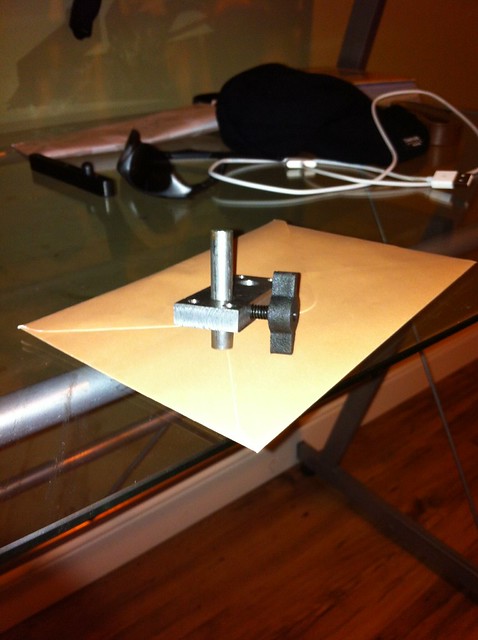

Next I decided I better get started on my cheek piece hardware. The part that screws into the cheek piece itself is what I worked on tonight. Here's how that piece turned out. Next will be the clamp part that goes into the stock, more on that later.

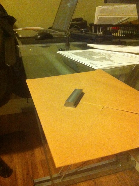

And finally, I needed a bipod stud adapter to use in my rail to mount my harris bipod. I got the shape of it milled out. I still have to put the set screw and the stud in it, but you get the idea :)

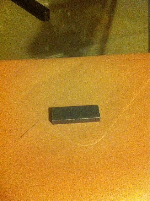

Got the square bar milled to the right thickness!
And now it's milled to the desired T-shape!
Making my own hardware!

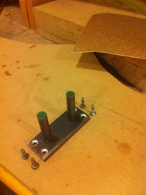

Tonight I just had a small amount of time, so I made the cheek piece riser base plate. Got the holes drilled and the threaded holes in the side of the base for the bolts that lock things in place.
