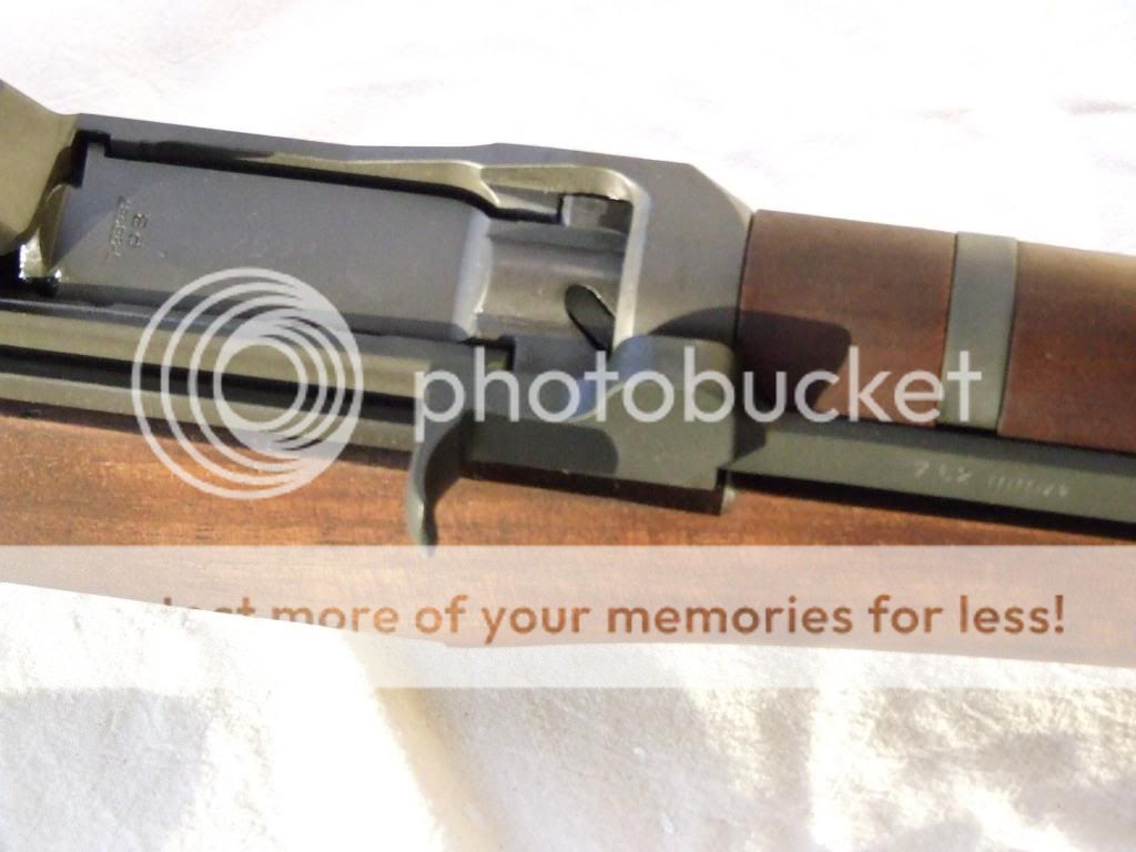

Very nice! I've never seen an op rod with "7.62" on it, was that standard for all converted Garands? Besides the smaller gas port on the .308 bbl and the magazine block, are the .308 op rod specs different from the .30/06?
gas port is larger on the 308. less power than the 06 needs more gas volume to make up for the lower pressure.
The oprod is just shorter by 1/2 inch, otherwise identical
What would you ask for such a thing.
My bad, thanks for that!
How scarce are the 7.62 op rods?
Edit: just did a quick search and it looks like you can use a standard .30/06 op rod if the .308 bbl is the same length as the typical .30/06 bbl. The Italians used shorter bbls in the .308 version, hence the shorter op rod.
