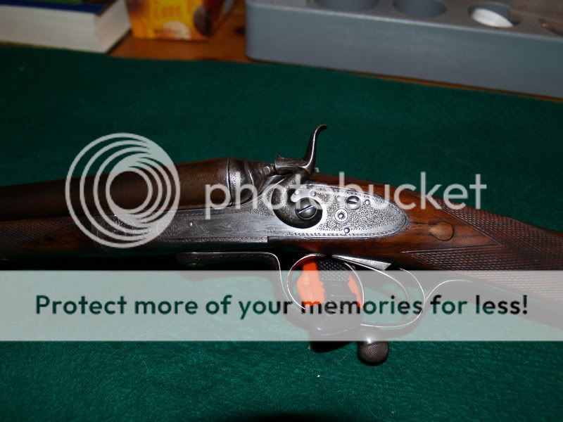

Is that a crack on the stock running from the end of the triggerplate towards the lockplate? Or is it just the picture? If it is a crack fix it before it completely breaks.
The wrist was broken right through. I milled a slot in the wrist about 3/4 of the depth of the wrist and 3/8 wide x roughly 3" long. Then epoxied a walnut "cookie" in of almost the same dimension. It seems to be standing up and I have run about 100 shells through the gun so far. The repair is completely hidden under the trigger guard tang.

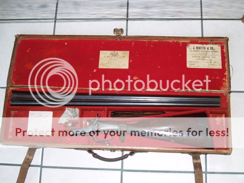

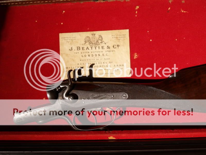

J. Beattie 12 gauge
