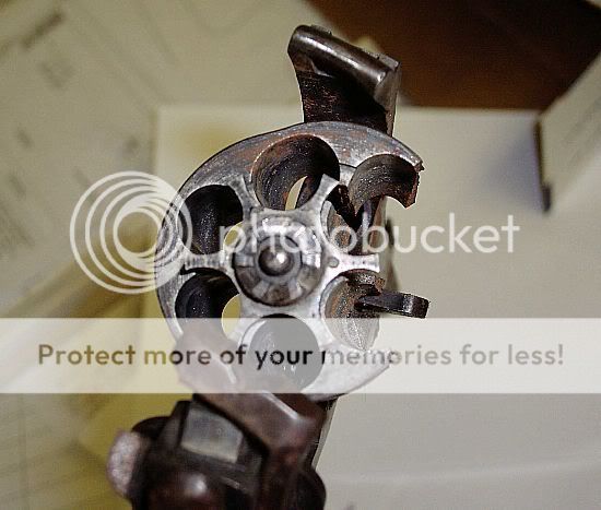

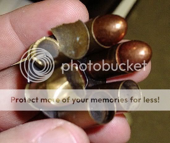

Failures can - and do - happen! For example, here is one altered Webley Mark VI which suffered a catastrophic failure firing .45 ACP ammunition -
In the above photos note that, not only did the cylinder rupture, but the barrel catch (i.e the stirrup which engages the rear of the top strap when the revolver is closed up) has obviously failed as well. Here are some photos of another Mark VI Webley altered to fire .45 ACP, posted by a chap who had just purchased the revolver. Note that the barrel catch had obviously been brazed to repair a similar failure. We were able to caution this fellow that the revolver was likely unsafe to fire with any load, and steer him to where he could get a replacement barrel catch .....

Ya same old picture thats been around for ever.
If so many webley MKIs and MKIIs are blowing up why is it that people have to use that same picture thats been around since the start of the internet LOL

That picture and a few others out there are old and there was a story it was some hot reloaded target round that caused that cylinder to blow up.
Not factory ammo so the storys and picture dont even match.
