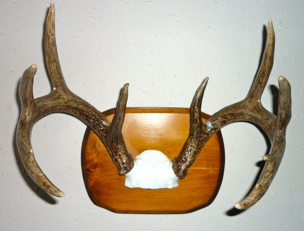

You could do something like I did last year. I painted the bone white and sprayed semigloss clear on the antlers. It is screwed on to the plaque with wood screws
