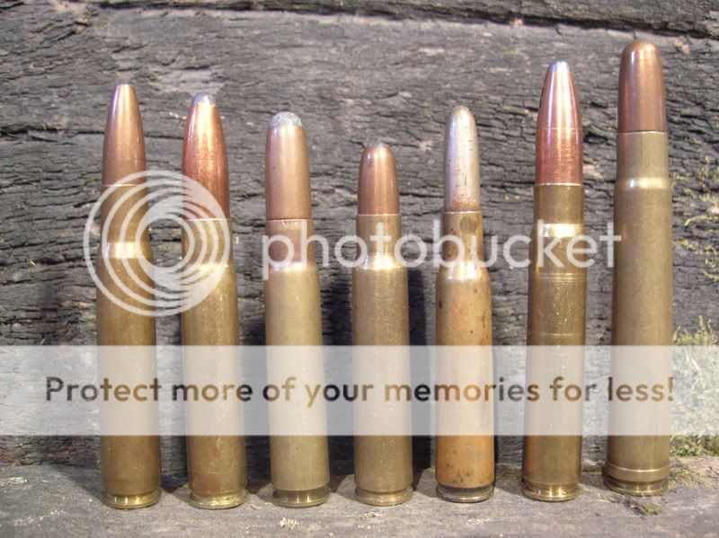

Noel,
What a great lineup!!:cool: The only ones missing are the 9,3X64 and 9,3X74R, and I'll forgive you for that.;)

Thanks! I would put the Brenneke and the X72 in the line up if I had them, My collection has only been found to be missing alot of metrics as of last year!:redface:
