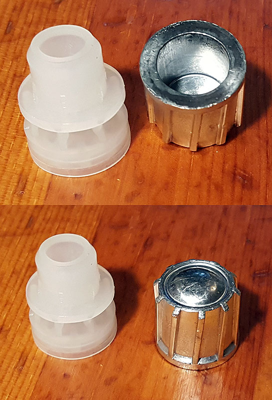

Medvedqc, ... yes the S&B looks like a Brenneke copy .... but after closer examination it is not really a Brenneke copy. The slug is not as solidly built as a Brenneke ... and it is hollow at its base. It resembles more a Foster slug with a plastic tail wad attached.

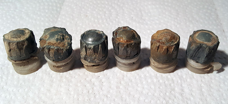

Here a picture comparing a Brenneke shot into wood and the S&B.
The two slugs to the left are Brennekes ... and the second from the right is the S&B (the tail wad got stripped while the slug traveled through the wood):

Adding this picture .... this is an S&B Sport slug ... and as one can see from the picture ... the slug is hollow like a Foster slug .... whereas the Brenneke (original Brenneke) has a pretty solid center base ....
