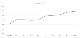

Here is the Velocity String. One node at around 2650 at 40-40.7 Powder Charge and one are 2705 at 41.3-41.5 Powder Charge.

You don't mention the powder or bullet weight, but you are running about what the max is for 6.5cm and 140's for velocity with the ideal powders.
Don't buy into Internet loads where the 6.5cm can hit 3000fps with 140's and not be over pressure.

You got a little room left, but not much buddy, settle on 2650-2700fps, your brass will let you know, when primers start seating with no effort on reloading that brass is when you know you should go lower.
Regular healthy pressure, should get 10+ loads out of decent brass like that (not Federal don't bother using that stuff).
If you are hitting stretched primer pockets after 3 or 4 loadings, dial her back a bit.
Yes 100%. No intention of going nuclear with this load. 2700 and I’m happy.
There may be a mode around 2740-2750 but that will be on the limit so no point going after that.
I think I’m going to try 41.4 / 41.5 / 41.6
These are also jumping 20/30 thousandths
Mike
