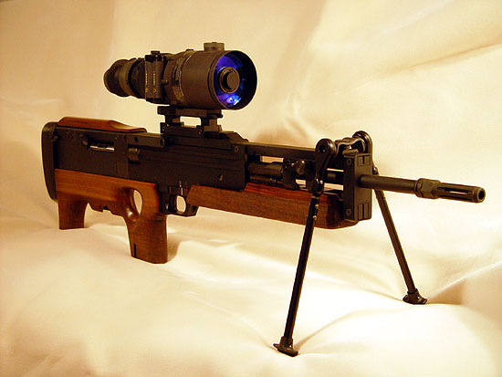

I am thinking of the keltec in a 32" barrel. I do want a semi auto, but I want a semi-auto target rifle.
Those exist, no? Or is this the only one (only what? 45-50K for that?):
You know you may be right. maybe I should be looking at tactical Bolt rifles? Like Blaser's (ok, not the cheapest, definitely not $1500), Savage Bas-k's, Sako's....
Not sure. Is there any reason why a bolt action rifle is more precise than a semi, when it comes to higher end tactical stuff?
