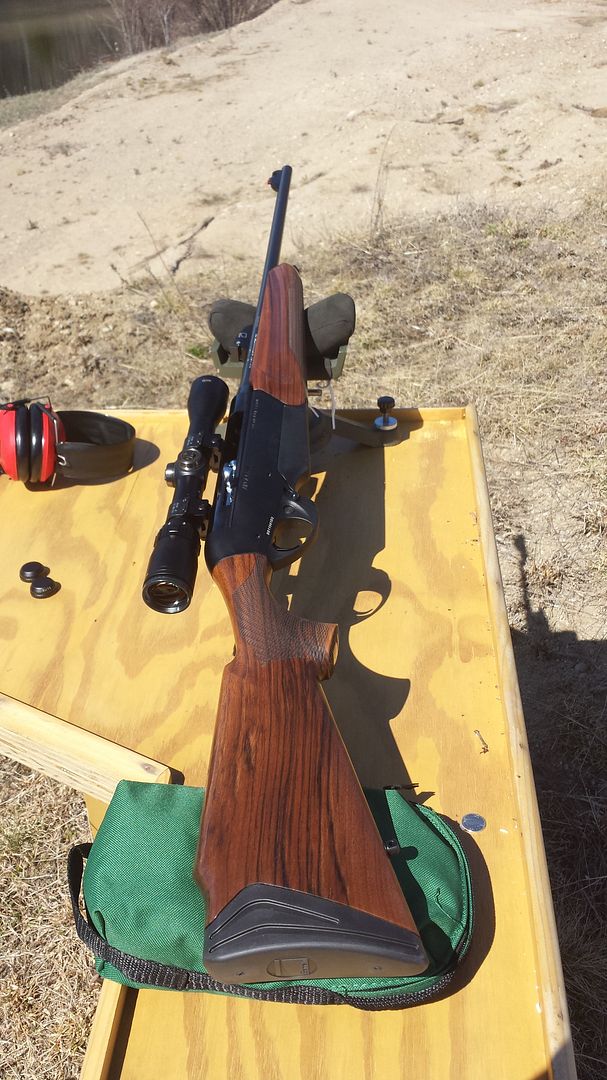

Got her out for a run today, runs like a champ, shoots like an SKS lol.
Gonna need some load development to get this thing shooting under 3"....
