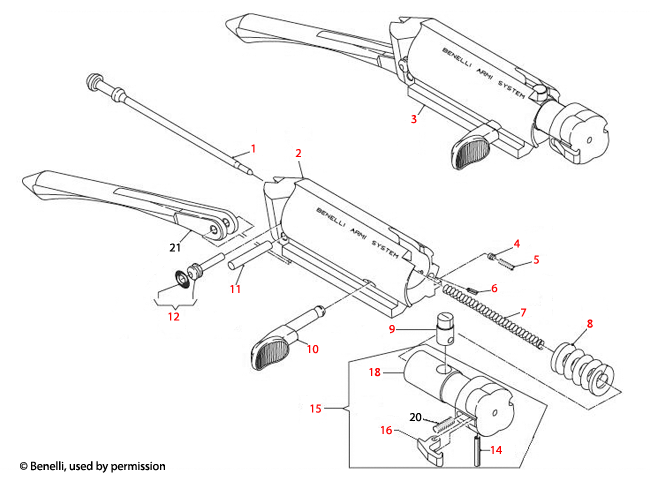

Was it cleaned and lubed? Everyone says Benellis should be run dry but my buddies SBE2 was always giving him grief until one day I watched to see him work it and the action slid closed like it was in molasses and had to be hand locked into battery by pushing ahead on the bolt. I said maybe you oiled it too heavy and he said he doesn’t lube it at all as he was told to run it dry. I grabbed my remoil in my blind bag and gave the bolt mechanism a light shot and wha-la away it went working perfectly. All these years later he still runs it dry then gets po’d when it starts jamming and out comes my remoil to get him back in the game again.....:rolleyes:
And the choke won’t change how it works. If it was a gas operated gun I’d say clean the gas valve and barrel bleed off holes but it’s an inertia operated gun. If the shell generates the required rearward energy needed to blow the bolt rearward it should function.
I bet he took it apart and then put the spacers back in wrong. I don't know how Benelli's go together but every other recoil operated gun I've seen has a right way and a wrong way to install the washers. A little oil might not hurt but there is very little that will stop a recoil operated gun from cycling.
If you're talking about the friction rings like on the old Auto 5's the Benelli's don't have that. It's just a bolt with a tail on it. The tail compresses a spring which is what sends the bolt back up into battery after firing.

My shot in the dark would be lack of proper lubrication or depending on round count, age, etc. It's possible that the recoil spring is worn out, too weak for the rounds he's using, or broken.

The Benelli shotguns are like ak47's, they rarely have problems. If it was my gun and I was having this problem I would take the gun apart and give it a good cleaning. Then lightly lube the moving parts. The Benelli's are so simple to clean and lube is should not be a problem. Second problem might be the action spring in the stock, especially if any water has ever got into it. Remove stock and inspect spring for any signs of rust. The stock spring usually is good for many hundreds of rounds. Thirdly operator error, is the shooter holding the stock of the gun firmly against his shoulder? The bolt to cycle properly needs a ferm hold against the shoulder or it will fail to work properly.
