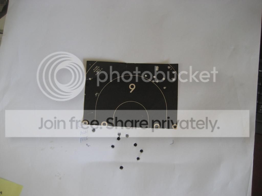

I load my 18" M305 for two different competitions. CQB, shot at 25 yards. I load 27gr of 4895 powder. Gun functions 100% and kicks like a BB gun. For Vintage Rifle, shot back to 300 yards, I load 42gr of 4895. I use bullets similar to yours. Accuracy is good enough for the application. If I wanted to use match bullets, I would choose 155 or the Sierra 175.
10 shots - 200 yards Vintage Rifle Match 18.5" Norinco M305, almost stock
