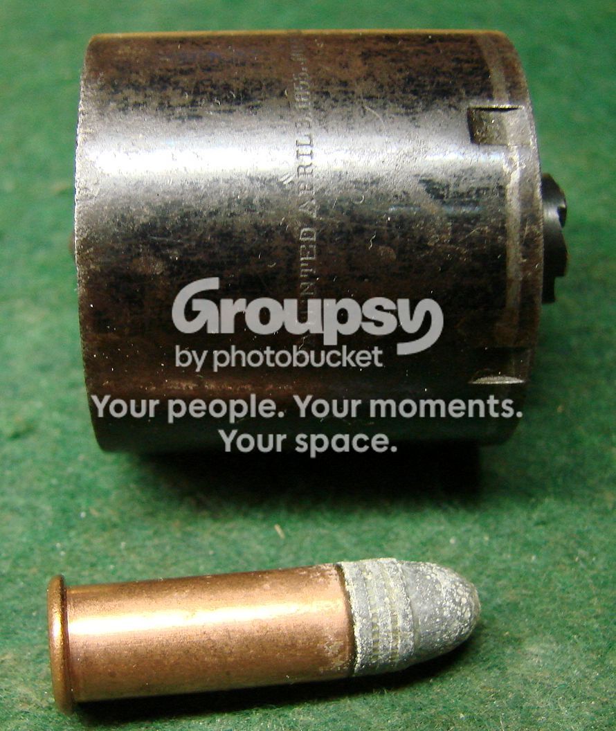

I measured the chamber walls, .044 to the outside, .088 to the next chamber. I don't know what a good wall is for a .32 rf tho. I thought the Colt Thunderer chambers looked a little spooky, they measure .049 on the outside, and only .042 to the next hole. And a lot more bang.

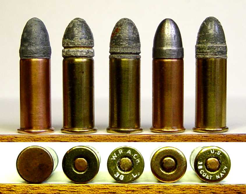

There is a 32 Rf ammo that i think is pretty hot its canuck ammo has a copper looking bullet to match the case. its got way more zap than cil.
I shot some CIL in my tranter 7 shot 32 Rf and it was so week some were ok some were very gutless. that copper Canuck stuff tho its like a Std 22 LR round.

A S&W #2 Army .32 cyl. wall is only .049. A lot af the #2 guns where carried in the Civil war, and with the same hinge too. A big Moores is .066, and a Marlin in .30 cal is only .039. A Tranter 7 shot .32 is .062. A very solid gun.

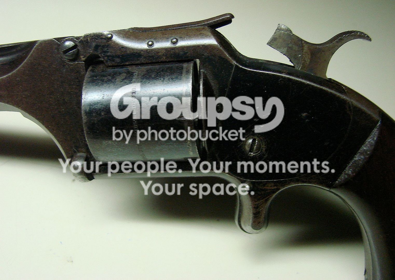

I've not shot my .32 1 1/2. It is in excellent condition, tight, crisp, most original bright blue and most varnish on the rosewood stocks. The mechanism is a bit different than some other early revolvers, with the lockup being on top of the cylinder. Certainly much better made than many other .32 revolvers.

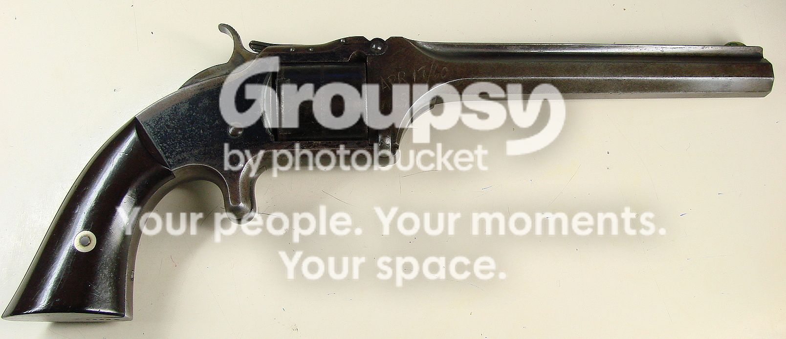

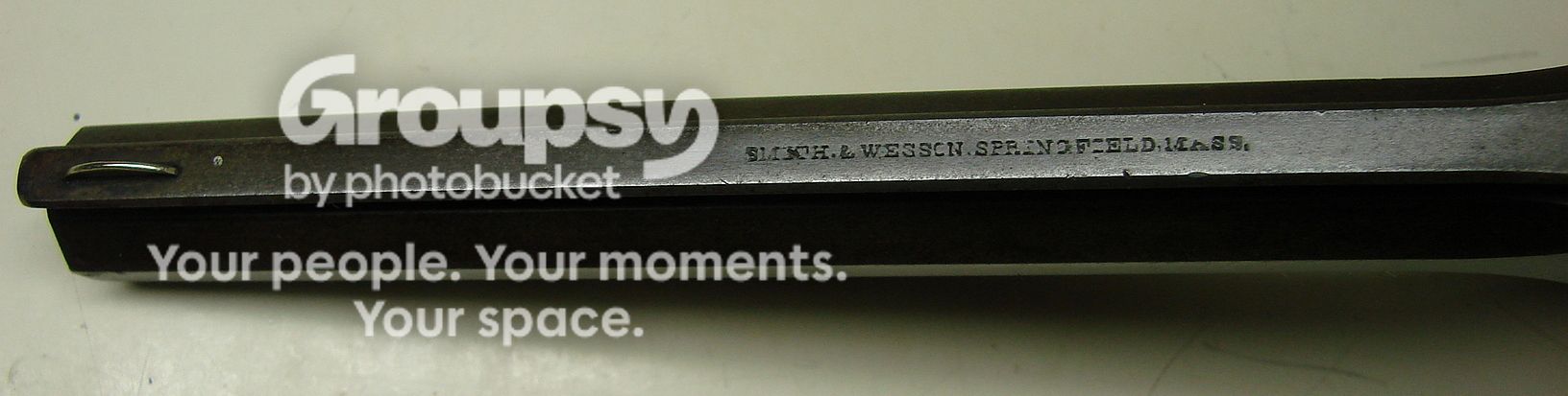

I inherited this S&W Model No.2 Old Model revolver (a.k.a. Model No.2 Army)
.32 caliber Long Rim Fire, (Smith & Wesson Number 2 cartridge.)
from my father in-law in 1991.
These guns were manufactured between 1861 & 1872.
The serial number on this gun is 42584 and was probably manufactured around 1868.

I believe the police decided to commemorate the event by scratching the date of the event on the gun...otherwise it is in pretty decent condition.
I have been looking for an ejection lug which is missing….I doubt I will ever find an original replacement part.
