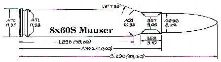

I bought 2 BRNO 21H's in 8x60S (.323).
Looked around the internet for load data. Found a bit of data.
I have been forming 30/06 brass to make the 8x60S. Trimming to about 60mm which seems to be the general consensus. Need specific trim to length to be certain.
I will be reloading for Sierra 175/220gr, Speer 170/200gr, & Hornady 196/220gr (if I can find 220gr some) bullets.
Any suggestions for loads. I'm thinking I can use 8mm/06 load data minus about 5%.
Thanks.
I got a 8x60S Brno 21 cheap some years ago, loaded up 200 grs old Sako Hammerheads to 2670 fps with Vihtavuori N140 53 grs, and Woodleigh 250 grs to 2390 fps with Vihtavuori N 150 49 grs - a bullet with very pleasing sectional density. The second load is point of aim with open sights at 75 m and the first 10 cm over.
